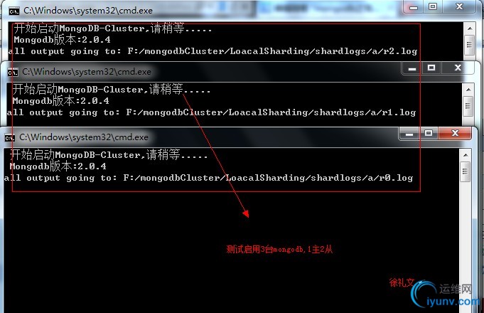

10.106
bin/mongod --shardsvr --fork --replSet sky --port=9998 --logpath=/data/mongodb/mongodb.log --dbpath=/data/mongodb --directoryperdb --rest >> /dev/null 2>&1 &
10.107
10.103
web端图:

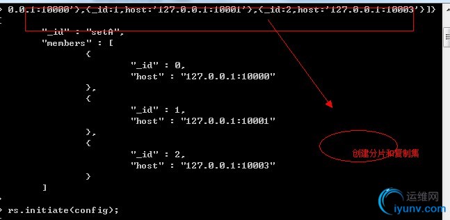

我这里以10.107作为主服务器
进行配置:
>config = {_id: 'sky', members: [
{_id: 0, host: '192.168.10.107:9998'},
{_id: 1, host: '192.168.10.106:9998'},
{_id: 2, host: '192.168.10.103:9998'}]
配置文件的语法是:
_id : ,
members: [
_id : ,
host : ,
[, priority: ]
[, arbiterOnly : true]
[, votes : ]
[, hidden : true]
[, slaveDelay : ]
[, buildIndexes : ]
[, initialSync : {
[state : 1|2,]
[_id : ,]
[name : ,]
[optime : ]}]
[settings: {
[getLastErrorDefaults: ]
[, heartbeatSleep : ]
[, heartbeatTimeout : ]
[, heartbeatConnRetries : ]
详细参数请参考http://www.mongodb.org/display/DOCS/Replica+Set+Configuration 按需使用
>rs.initiate(config) 出现以下提示为配置成功
"info" : "Config now saved locally. Should come online in about a minute.",
"ok" : 1
