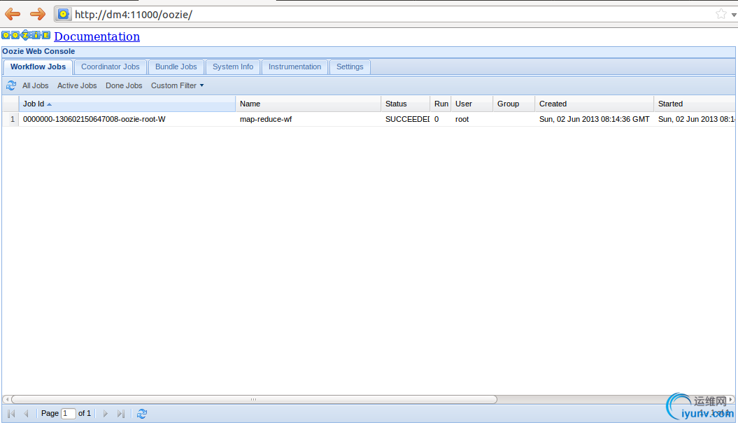

运行结果:
job: 0000000-130602150647008-oozie-root-W
  不上传会出现如下错误:
root@dm4:/home/oozie/distro/target/oozie-3.3.2-distro/oozie-3.3.2# bin/oozie job -oozie http://localhost:11000/oozie -config examples/apps/map-reduce/job.properties -run
Error: E0504 : E0504: App directory [hdfs://211.80.198.148:9000/user/root/examples/apps/map-reduce] does not exist
  结果
