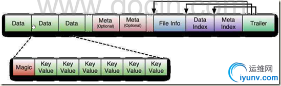

  现在我们将深入HBase存储架构的核心,探讨HBase具体的数据存储文件的结构。HFile就是这个数据存储文件的结构(Ryan Rawson就是靠它扬名立万的)。
创建HFile这样一个文件结构的目的只有一个:快速高效的存储HBase的数据。HFile是基于Hadoop TFile的(see HADOOP-3315)。HFile模仿了Google Bigtable中SSTable的格式。原先HBase使用Hadoop的MapFile,但是这种文件已经被证明了效率差。现在让我们来看看这个文件结构到底是什么样的。
  The files have a variable length, the only fixed blocks are the FileInfo and Trailer block.
As the picture shows it is the Trailer that has the pointers to the other blocks and it is written at the end of persisting the data to the file, finalizing the now immutable data store.
The Index blocks record the offsets of the Data and Meta blocks. Both the Data and the Meta blocks are actually optional. But you most likely you would always find data in a data store file.
  因为HFile是模仿SSTable, sorted string table, 所以是存放按key排序的一堆key-value数据. 为了便于管理, data分为blocks, 并且在文件末有index便于快速定位block. 而Trailer是用来定位index等管理数据的. 之所以可以把管理数据放在文件末尾, 因为SSTable一旦生成就是不可变的.
  那么每个block的大小是如何确定的呢?
这个值可以在创建一个Table的时候通过HColumnDescriptor(实际上应该称作FamilyDescriptor)来设定。这里我们可以看一个例子:
  {NAME => ‘docs’, FAMILIES => [{NAME => ‘cache’, COMPRESSION => ‘NONE’, VERSIONS => ’3′, TTL => ’2147483647′, BLOCKSIZE => ’65536′, IN_MEMORY => ‘false’, BLOCKCACHE => ‘false’}, {NAME => ‘contents’, COMPRESSION => ‘NONE’, VERSIONS => ’3′, TTL => ’2147483647′, BLOCKSIZE => ’65536′, IN_MEMORY => ‘false’, BLOCKCACHE => ‘false’}, …
  从这里可以看出这是一个叫做docs的Table,它有两个Family:cache和contents,这两个Family对应的HFile的数据块的大小都是64K。
  The default is "64KB" (or 65535 bytes). Here is what the HFile JavaDoc explains:
"Minimum block size. We recommend a setting of minimum block size between 8KB to 1MB for general usage.
Larger block size is preferred if files are primarily for sequential access. However, it would lead to inefficient random access (because there are more data to decompress). Smaller blocks are good for random access, but require more memory to hold the block index, and may be slower to create (because we must flush the compressor stream at the conclusion of each data block, which leads to an FS I/O flush). Further, due to the internal caching in Compression codec, the smallest possible block size would be around 20KB-30KB."
  block大小的选择, 选比较大的size, 便于sequential access, 但不适合random access, 因为你就是读1byte也要把整个block解压缩(我本来以为是在大block中查找数据效率低, 有序的, 二分效率差别不大)
  选小的size, overhead会比较大, 比如block index, 所以也需要balance.
  Each block contains a magic header, and a number of serialized KeyValue instances (see the section called “KeyValue Format” for their format).
If you are not using a compression algorithm, then each block is about as large as of the configured block size. This is not an exact science as the writer has to fit whatever you give it: if you store
a KeyValue that is larger than the block size, then the writer has to accept that. But even with smaller values, the check for the block size is done after the last value was written, so in practice the majority of blocks will be slightly larger.
这儿要注意, block size 64kb, 非严格的标准, 实际上都会稍微大一些. 这个和bigtable的设计不一样, bigtable会把record分多个block.
  If you have compression enabled the data saved will be less. This means for the final store file that it is comprised of the same amount of blocks, but the total size is less since each block is smaller.
  如果对block打开compression选项的话, block的个数不变, 但是每个block的size会变小.

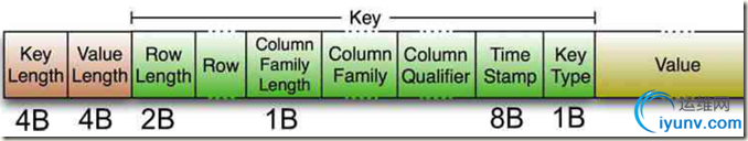

KeyValue Format
  In essence each KeyValue in the HFile is simply a low-level byte array that allows for "zero-copy" access to the data, even with lazy or custom parsing if necessary. How are the instances arranged?
  The structure starts with two fixed length numbers indicating the size of the key and the value part.
  开始是两个固定长度的数值,分别表示Key的长度和Value的长度。紧接着是Key,开始是固定长度的数值,表示RowKey的长度,紧接着是 RowKey,然后是固定长度的数值,表示Family的长度,然后是Family,接着是Qualifier,然后是两个固定长度的数值,表示Time Stamp和Key Type。Value部分没有这么复杂的结构,就是纯粹的数据。
  With that info you can offset into the array to for example get direct access to the value, ignoring the key - if you know what you are doing. Otherwise you can get the required information from the key part. Once parsed into a KeyValue object you have getters to access the details.
  The reason why in the example above the average key is larger than the value can be attributed to the contained fields in the key:
it includes the fully specified dimensions of the cell. The key holds the row key, the column family name, the column qualifier, and so on.
For a small payload this results in quite a considerable overhead. If you deal with small values, then try to keep the key small as well. Choose a short row and column key (the family name with a single byte, and the qualifier equally short) to keep the ratio in check.
  这幅图是这篇blog里面最有价值的, 我看bigtable相关就一直在想, SSTable只能存kv, 那么多key, row key, column key, timestamp怎么存, 这边太清楚了, good.
