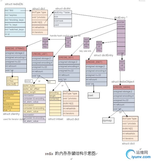

  redisDb 的定义:
  typedef struct redisDb
  dict *dict;                 /* The keyspace for this DB */
  dict *expires;              /* Timeout of keys with a timeout set */
  dict *blocking_keys;    /* Keys with clients waiting for data (BLPOP) */
  dict *io_keys;              /* Keys with clients waiting for VM I/O */
  dict *watched_keys;         /* WATCHED keys for MULTI/EXEC CAS */
  int id;
  } redisDb;
  struct
  redisDb 中 ,dict 成员是与实际存储数据相关的. dict 的定义如下:
  typedef struct dictEntry
  void *key;
  void *val;
  struct dictEntry *next;
  } dictEntry;
  typedef struct dictType
  unsigned int (*hashFunction)(const void *key);
  void *(*keyDup)(void *privdata, const void *key);
  void *(*valDup)(void *privdata, const void *obj);
  int (*keyCompare)(void *privdata, const void *key1, const void *key2);
  void (*keyDestructor)(void *privdata, void *key);
  void (*valDestructor)(void *privdata, void *obj);
  } dictType;
  /* This is our hash table structure. Every dictionary has two of this as we
  * implement incremental rehashing, for the old to the new table. */
  typedef struct dictht
  dictEntry **table;
  unsigned long size;
  unsigned long sizemask;
  unsigned long used;
  } dictht;
  typedef struct dict
  dictType *type;
  void *privdata;
  dictht ht[2];
  int rehashidx; /* rehashing not in progress if rehashidx == -1 */
  int iterators; /* number of iterators currently running */
  } dict;
  dict 是主要是由 struct dictht 的 哈唏表构成的, 之所以定义成长度为2的( dictht ht[2] ) 哈唏表数组,是因为 redis 采用渐进的 rehash,即当需要 rehash 时,每次像 hset,hget 等操作前,先执行N 步 rehash. 这样就把原来一次性的 rehash过程拆散到进行, 防止一次性 rehash 期间 redis 服务能力大幅下降. 这种渐进的 rehash 需要一个额外的 struct dictht 结构来保存.
  struct dictht 主要是由一个 struct dictEntry 指针数组组成的, hash 表的冲突是通过链表法来解决的.
  struct dictEntry 中的 key 指针指向用 sds 类型表示的 key 字符串, val 指针指向一个 struct redisObject 结构体, 其定义如下:
  typedef struct redisObject
  unsigned type:4;
  unsigned storage:2;   /* REDIS_VM_MEMORY or REDIS_VM_SWAPPING */
  unsigned encoding:4;
  unsigned lru:22;        /* lru time (relative to server.lruclock) */
  int refcount;
  void *ptr;
  /* VM fields are only allocated if VM is active, otherwise the
  * object allocation function will just allocate
  * sizeof(redisObjct) minus sizeof(redisObjectVM), so using
  * Redis without VM active will not have any overhead. */
  } robj;
  //type 占 4 bit,用来表示 key-value 中 value 值的类型,目前 redis 支持: string, list, set,zset,hash 5种类型的值.
  /* Object types */
  #define REDIS_STRING 0
  #define REDIS_LIST 1
  #define REDIS_SET 2
  #define REDIS_ZSET 3
  #define REDIS_HASH 4
  #define REDIS_VMPOINTER 8
  // storage 占 2 bit ,表示 此值是在 内存中,还是 swap 在硬盘上.
  // encoding 占 4 bit ,表示值的编码类型,目前有 8种类型:
  /* Objects encoding. Some kind of objects like Strings and Hashes can be
  * internally represented in multiple ways. The 'encoding' field of the object
  * is set to one of this fields for this object. */
  #define REDIS_ENCODING_RAW 0     /* Raw representation */
  #define REDIS_ENCODING_INT 1     /* Encoded as integer */
  #define REDIS_ENCODING_HT 2      /* Encoded as hash table */
  #define REDIS_ENCODING_ZIPMAP 3  /* Encoded as zipmap */
  #define REDIS_ENCODING_LINKEDLIST 4 /* Encoded as regular linked list */
  #define REDIS_ENCODING_ZIPLIST 5 /* Encoded as ziplist */
  #define REDIS_ENCODING_INTSET 6  /* Encoded as intset */
  #define REDIS_ENCODING_SKIPLIST 7  /* Encoded as skiplist */
  /* 如 type 是 REDIS_STRING 类型的,则其值如果是数字,就可以编码成 REDIS_ENCODING_INT,以节约内存.
  * 如 type 是 REDIS_HASH 类型的,如果其 entry 小于配置值: hash-max-zipmap-entries 或 value字符串的长度小于 hash-max-zipmap-value, 则可以编码成 REDIS_ENCODING_ZIPMAP 类型存储,以节约内存. 否则采用 Dict 来存储.
  * 如 type 是 REDIS_LIST 类型的,如果其 entry 小于配置值: list-max-ziplist-entries 或 value字符串的长度小于 list-max-ziplist-value, 则可以编码成 REDIS_ENCODING_ZIPLIST 类型存储,以节约内存; 否则采用 REDIS_ENCODING_LINKEDLIST 来存储.
  *  如 type 是 REDIS_SET 类型的,如果其值可以表示成数字类型且 entry 小于配置值set-max-intset-entries, 则可以编码成 REDIS_ENCODING_INTSET 类型存储,以节约内存; 否则采用 Dict类型来存储.
  *  lru: 是时间戳
  *  refcount: 引用次数
  *  void * ptr : 指向实际存储的 value 值内存块,其类型可以是 string, set, zset,list,hash ,编码方式可以是上述 encoding 表示的一种.
  * 至于一个 key 的 value 采用哪种类型来保存,完全是由客户端的指令来决定的,如 hset ,则值是采用REDIS_HASH 类型表示的,至于那种编码(encoding),则由 redis 根据配置自动决定.

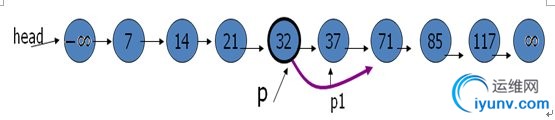

  3) deleteing a key from a sorted list
  //To delete 37 -
  p=find(37);
  CELL *p1 =p->next;
  p->next = p1->next ;
  free(p1);

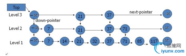

1.7.1.2 SkipList(跳跃表)定义
  SKIP LIST : A data structure for maintaing a set of keys in a sorted order.
  Consists of several levels.
  All keys appear in level 1
  Each level is a sorted list.
  If key x appears in level i, then it also appears in all levels below i
  An element in level i points (via down pointer) to the element with the same key in the level below.
  In each level the keys and appear. (In our implementation, INT_MIN and INT_MAX
  Top points to the smallest element in the highest level.
1.7.1.3 SkipList(跳跃表)操作
  1) An empty SkipList
  2) Finding an element with key x

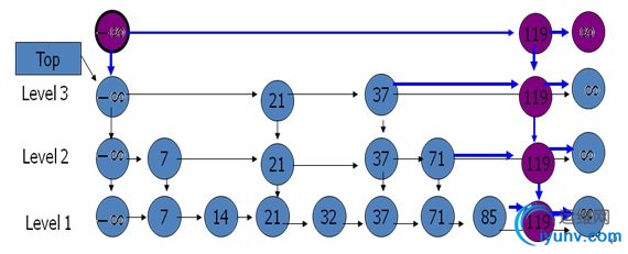

  3) Inserting new element X
  Determine k the number of levels in which x participates (explained later)
  Do find(x), and insert x to the appropriate places in the lowest k levels. (after the elements at which the search path turns down or terminates)
  Example – inserting 119. k=2
  If k is larger than the current number of levels, add new levels (and update top)
  Example – inser(119) when k=4
  Determining k
  k – the number of levels at which an element x participate.
  Use a random function OurRnd() — returns 1 or 0 (True/False) with equal probability.
  k=1 ;
  While( OurRnd() ) k++ ;

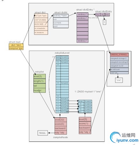

  2) ZADD myzset 1 “one”
  ZADD 命令格式:
  ZADD key score member
  • 根据 key 从 redisDb 进行查询,返回 zset 对象。
  • 以 member 作为 key,score 作为 value ,向 zset的 dict 进行中插入;
  • 如果返回成功,表明 member 没有在 dict 中出现过,直接向 skiplist 进行插入。
  • 如果步骤返回失败,表明以 member 已经在 dict中出现过,则需要先从 skiplist 中删除,然后以现在的 score 值重新插入。

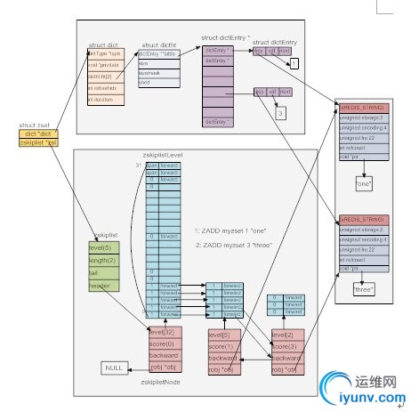

  3) ZADD myzset 3 “three”
  4) ZADD myzset 2 “two”
