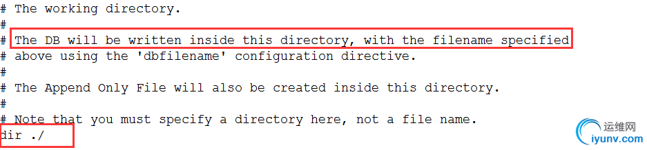

  数据保存的目录:

# The working directory.
# The DB will be written inside this directory, with the filename specified
# above using the 'dbfilename' configuration directive.
# The Append Only File will also be created inside this directory.
# Note that you must specify a directory here, not a file name.
dir ./
