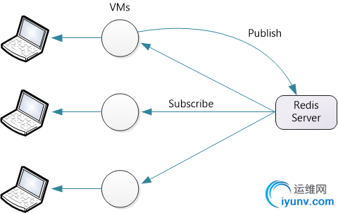

  Redis is an in-memory key-value store. It also supports a messaging system with a publish/subscribe model. The SignalR Redis backplane uses the pub/sub feature to forward messages to other servers.

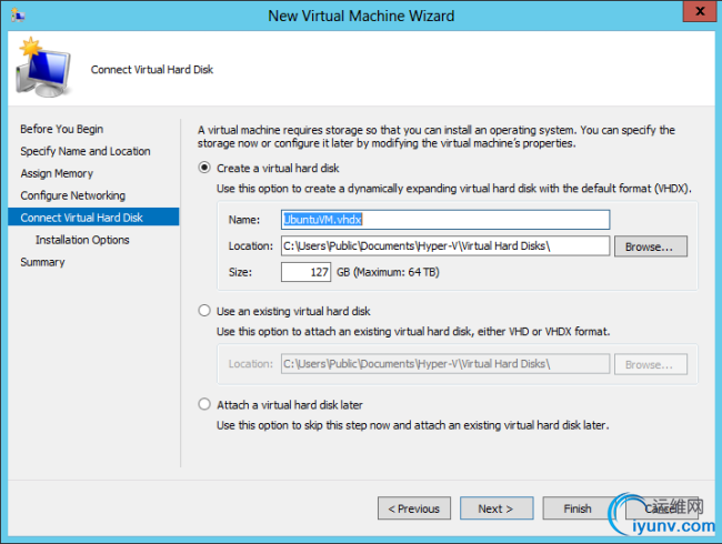

  Using Windows Hyper-V, you can easily create an Ubuntu VM on Windows Server.
  Download the Ubuntu ISO from http://www.ubuntu.com.

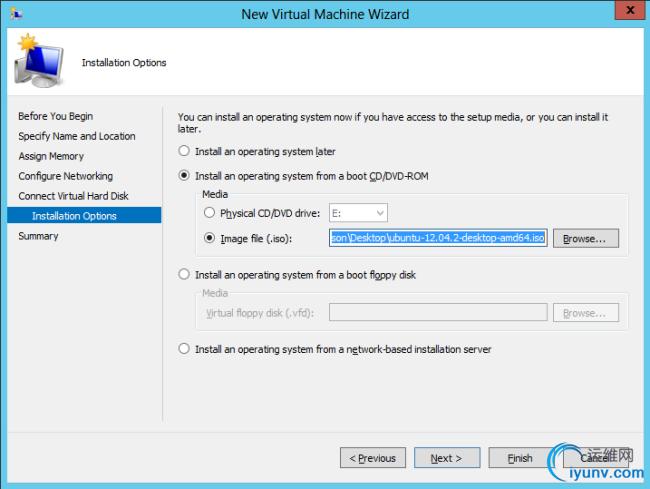

  In Hyper-V, add a new VM. In the Connect Virtual Hard Disk step, select Create a virtual hard disk.
  In the Installation Options step, select Image file (.iso), click Browse, and browse to the Ubuntu installation ISO.

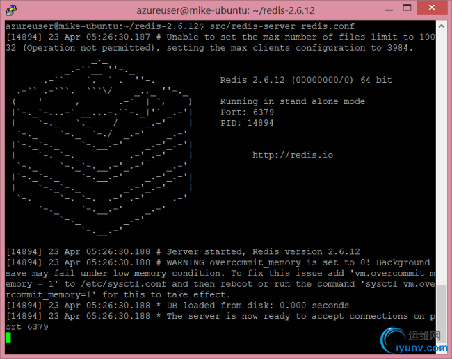

  Now start the Redis server:
src/redis-server redis.conf
  Open port 6379, which is the default port that Redis listens on. (You can change the port number in the configuration file.)

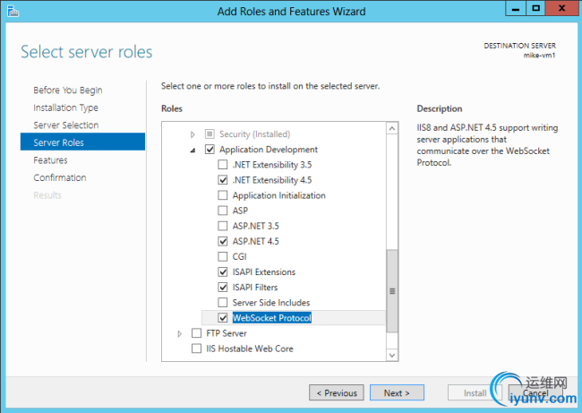

  Add the IIS role. Include “Application Development” features, including the WebSocket Protocol.

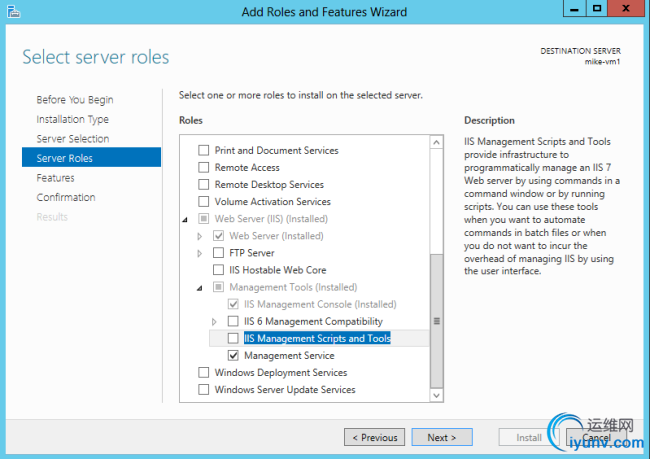

  Also include the Management Service (listed under “Management Tools”).

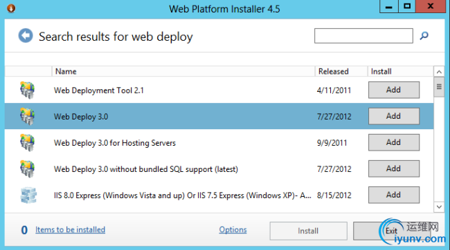

  Install Web Deploy 3.0. When you run IIS Manager, it will prompt you to install Microsoft Web Platform, or you can download the intstaller. In the Platform Installer, search for Web Deploy and install Web Deploy 3.0

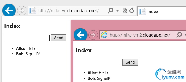

  If you deploy the application to two servers, you can open each instance in a separate browser window and see that they each receive SignalR messages from the other. (Of course, in a production environment, the two servers would sit behind a load balancer.)
