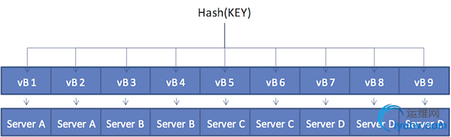

  The diagram below shows how the Key to Server mapping (vBucket map) works. There are three servers in the cluster. A client wants to look up ( get ) the value of KEY. The client first hashes the key to calculate the vBucket which owns KEY. In this example, the hash resolves to vBucket 8 ( vB8 ) By examining the vBucket map, the client determines Server C hosts vB8. The get operation is sent directly to Server C.

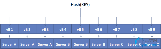

  After some period of time, there is a need to add a server to the cluster. A new node, Server D is added to the cluster and the vBucket Map is updated.
  The vBucket map is updated during the rebalance operation; the updated map is then sent the cluster to all the cluster participants, including the other nodes, any connected “smart” clients, and the Moxi proxy service.
  Within the new four-node cluster model, when a client again wants to get the value of KEY, the hashing algorithm will still resolve to vBucket 8 ( vB8 ). The new vBucket map however now maps that vBucket to Server D. The client now communicates directly with Server D to obtain the information.
