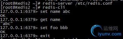

[iyunv@Redis2 ~]# redis-server /etc/redis.conf
[iyunv@Redis2 ~]# redis-cli
127.0.0.1:6379> set name abc
OK
127.0.0.1:6379> get name
"abc" 软件安装环境:centos6.5+redis2.8.11

下面测试一下服务情况
master:
slave:
数据成功同步!!!!
