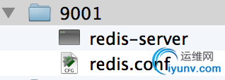

  1. create three instance folder: 9001,9002,9003,folder name as  redis instance port
  2.Store configuration files redis-server, redis.conf to the three folders
