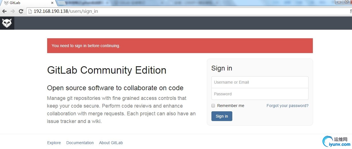

启动gitlab服务
[iyunv@gitlab ~]# service gitlab start

安装nginx包
[iyunv@gitlab ~]# yum install nginx -y
为gitlab配置反向代理的虚拟主机
9
10
11
12
13
14
[iyunv@gitlab ~]# vim /etc/nginx/conf.d/gitlab.conf
server {
    listen 80;
    server_name 192.168.190.138;
    client_max_body_size 512M;
    access_log  /var/log/nginx/gitlab_access.log;
    error_log   /var/log/nginx/gitlab_error.log;
    location / {
          proxy_pass http://192.168.190.138:8080;
启动nginx服务
[iyunv@gitlab ~]# service nginx start
为提供服务的可靠性,建议将这些服务都设为开机自启动
在浏览器中访问我们的IP地址
