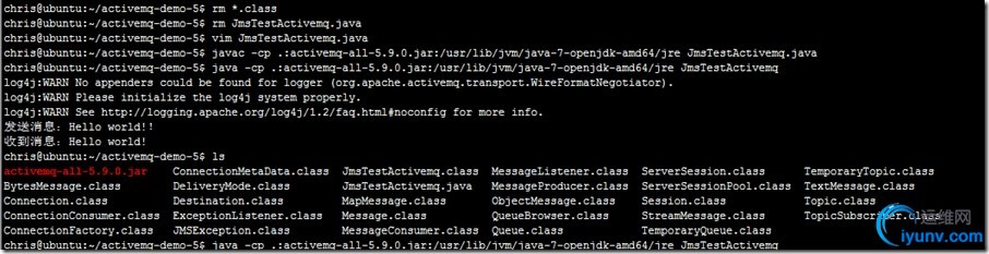

前面提到“里面写到了两个java程序,还是觉得麻烦”,是因为《JMS消息服务AcitveMQ的配置和测试小例子》原文给出的例程中有两个.java文件,需要建两个目录分别存放这两个.java文件,否则当一个.java文件编译通过后下面就会产生一些依赖性的.class文件,取决于编译的.java文件中的import的包的内容,因此一旦两个.java文件需要用到相同的依赖.class文件时就会引发编译冲突,提示“bad class file……Please remove or make sure it appears in the correct subdirectory of the classpath.”。因此我把这两个.java文件写成了一个,现粘贴如下(请将其保存成JmsTestActivemq.java):

//package com.jms;
// Refer:
// Refer:
import org.apache.activemq.ActiveMQConnection;
import org.apache.activemq.ActiveMQConnectionFactory;
import javax.jms.Connection;
import javax.jms.ConnectionFactory;
import javax.jms.DeliveryMode;
import javax.jms.Destination;
import javax.jms.ExceptionListener;
import javax.jms.JMSException;
import javax.jms.Message;
import javax.jms.MessageConsumer;
import javax.jms.MessageProducer;
import javax.jms.Session;
import javax.jms.TextMessage;
public class JmsTestActivemq {
        public static void main(String[] args) throws JMSException {
                ConnectionFactory connectionFactory = new ActiveMQConnectionFactory(
                                ActiveMQConnection.DEFAULT_USER,
                                ActiveMQConnection.DEFAULT_PASSWORD,
                                "tcp://58.67.199.171:61616");
                Connection connection = connectionFactory.createConnection();
                connection.start();
                Session session = connection.createSession(Boolean.TRUE, Session.AUTO_ACKNOWLEDGE);
                Destination destination = session.createQueue("jmstestqueue");
                MessageProducer producer = session.createProducer(destination);
                producer.setDeliveryMode(DeliveryMode.NON_PERSISTENT);
                TextMessage message = session.createTextMessage("Hello world!");
                System.out.println("发送消息:Hello world!");
                producer.send(message);
                // session.commit();
                session.close();
                connection.close();
                ConnectionFactory connectionFactory2 = new ActiveMQConnectionFactory(
                Connection connection2 = connectionFactory2.createConnection();
                connection2.start();
                Session session2 = connection2.createSession(Boolean.TRUE, Session.AUTO_ACKNOWLEDGE);
                Destination destination2 = session2.createQueue("jmstestqueue");
                MessageConsumer consumer = session2.createConsumer(destination2);
                while (true) {
                        TextMessage message2 = (TextMessage) consumer.receive(1000);
                        if (null != message2)
                                System.out.println("收到消息:" + message2.getText());
                        else
                                break;
                consumer.close();
                session2.close();
                connection2.close();
如果出现发送消息和收到消息则表示成功,运行结果如下:

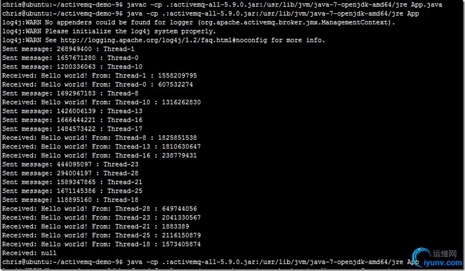

《JMS消息服务AcitveMQ的配置和测试小例子》原文中提到了“activemq官方也有个HelloWorld例子,http://activemq.apache.org/hello-world.html”,这个例子是activemq4的例子,activemq5的例子在http://activemq.apache.org/version-5-hello-world.html,这个官方的例子经过javac -cp .:activemq-all-5.9.0.jar:/usr/lib/jvm/java-7-openjdk-amd64/jre App.java后直接执行java -cp .:activemq-all-5.9.0.jar:/usr/lib/jvm/java-7-openjdk-amd64/jre App就可以运行,更为方便,结果(如果成功)如下:
