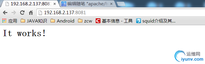

  /usr/local/apache/bin/apachectl start
  6.访问:
  http://192.168.2.137:8081/
