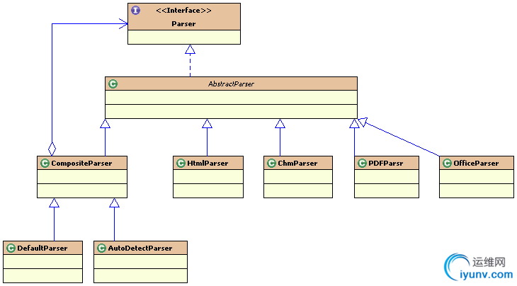

  先熟悉一下tika的解析类的相关接口和类的UML模型:

  下面接着贴出CompositeParser的源码,它继承自抽象类AbstractParser
* Composite parser that delegates parsing tasks to a component parser
* based on the declared content type of the incoming document. A fallback
* parser is defined for cases where a parser for the given content type is
* not available.
public class CompositeParser extends AbstractParser {

  Composite模式的简要UML模型图如下:
  我们接下来分析DefaultParser的源码,该类继承自CompositeParser类,用于初始化CompositeParser类的相关成员变量

List parsers =
loader.loadStaticServiceProviders(Parser.class);
Collections.sort(parsers, new Comparator() {
public int compare(Parser p1, Parser p2) {
String n1 = p1.getClass().getName();
String n2 = p2.getClass().getName();
boolean t1 = n1.startsWith("org.apache.tika.");
boolean t2 = n2.startsWith("org.apache.tika.");
if (t1 == t2) {
return n1.compareTo(n2);
} else if (t1) {
return -1;
} else {
return 1;
return parsers;
private transient final ServiceLoader loader;
public DefaultParser(MediaTypeRegistry registry, ServiceLoader loader) {
super(registry, getDefaultParsers(loader));
this.loader = loader;
public DefaultParser(MediaTypeRegistry registry, ClassLoader loader) {
this(registry, new ServiceLoader(loader));
public DefaultParser(ClassLoader loader) {
this(MediaTypeRegistry.getDefaultRegistry(), new ServiceLoader(loader));
public DefaultParser(MediaTypeRegistry registry) {
this(registry, new ServiceLoader());
public DefaultParser() {
this(MediaTypeRegistry.getDefaultRegistry());
@Override
public Map getParsers(ParseContext context) {
Map map = super.getParsers(context);
if (loader != null) {
// Add dynamic parser service (they always override static ones)
MediaTypeRegistry registry = getMediaTypeRegistry();
for (Parser parser
: loader.loadDynamicServiceProviders(Parser.class)) {
for (MediaType type : parser.getSupportedTypes(context)) {
map.put(registry.normalize(type), parser);
return map;
  该类主要是为基类初始化MediaTypeRegistry registry成员与List parsers成员,它本身并没有覆盖void parse(InputStream stream, ContentHandler handler,Metadata metadata, ParseContext context)方法,为的是执行基类的方法(根据mime类型执行具体parser类的parse方法)
  最后来分析AutoDetectParser类的源码,它也继承自CompositeParser类:
public class AutoDetectParser extends CompositeParser {
/** Serial version UID */
private static final long serialVersionUID = 6110455808615143122L;
* The type detector used by this parser to auto-detect the type
* of a document.
private Detector detector; // always set in the constructor
* Creates an auto-detecting parser instance using the default Tika
* configuration.
public AutoDetectParser() {
this(TikaConfig.getDefaultConfig());
public AutoDetectParser(Detector detector) {
setDetector(detector);
* Creates an auto-detecting parser instance using the specified set of parser.
* This allows one to create a Tika configuration where only a subset of the
* available parsers have their 3rd party jars included, as otherwise the
* use of the default TikaConfig will throw various "ClassNotFound" exceptions.
* @param detector Detector to use
* @param parsers
public AutoDetectParser(Parser...parsers) {
this(new DefaultDetector(), parsers);
public AutoDetectParser(Detector detector, Parser...parsers) {
super(MediaTypeRegistry.getDefaultRegistry(), parsers);
public AutoDetectParser(TikaConfig config) {
super(config.getMediaTypeRegistry(), config.getParser());
setDetector(config.getDetector());
* Returns the type detector used by this parser to auto-detect the type
* of a document.
* @return type detector
* @since Apache Tika 0.4
public Detector getDetector() {
return detector;
* Sets the type detector used by this parser to auto-detect the type
* of a document.
* @param detector type detector
public void setDetector(Detector detector) {
this.detector = detector;
public void parse(
throws IOException, SAXException, TikaException {
TemporaryResources tmp = new TemporaryResources();
try {
TikaInputStream tis = TikaInputStream.get(stream, tmp);
// Automatically detect the MIME type of the document
MediaType type = detector.detect(tis, metadata);
metadata.set(Metadata.CONTENT_TYPE, type.toString());
// TIKA-216: Zip bomb prevention
SecureContentHandler sch = new SecureContentHandler(handler, tis);
try {
// Parse the document
super.parse(tis, sch, metadata, context);
} catch (SAXException e) {
// Convert zip bomb exceptions to TikaExceptions
                sch.throwIfCauseOf(e);
throw e;
} finally {
tmp.dispose();
public void parse(
InputStream stream, ContentHandler handler, Metadata metadata)
ParseContext context = new ParseContext();
context.set(Parser.class, this);
parse(stream, handler, metadata, context);
  该类也初始化基类的MediaTypeRegistry registry成员与List parsers成员,不过这里的List parsers成员有TikaConfig类提供,后者默认提供的Parser实现类为DefaultParser
  它的void parse(InputStream stream, ContentHandler handler,Metadata metadata, ParseContext context)方法首先检测文档的mime类型,然后将解析处理委托给CompositeParser基类执行,自身对外提供接口
  所以整个解析的流程是
  一、AutoDetectParser的parse方法:首先检测文件的mime类型,然后将解析任务交给基类CompositeParser的parse方法
  二、AutoDetectParser的基类CompositeParser的parse方法:根据参数里面的mime类型获取解析类DefaultParser(支持所有已经注册的mime类型,由List parsers成员提供)
  三、调用DefaultParser的parse方法(DefaultParser默认执行父类的parse方法),即基类CompositeParser的parse方法,根据参数里面的mime类型获取具体解析类
  四、最后执行具体解析类的parse方法
  这里第一次AutoDetectParser初始化基类CompositeParser的parser组件集合是DefaultParser,基类CompositeParser的parse方法委托给DefaultParser
  第二次DefaultParser初始化基类的CompositeParser的parser组件集合是具体的parser实现类集合,基类CompositeParser的parse方法委托给具体的parser实现类
  这里体现的是Composite模式的运用。
