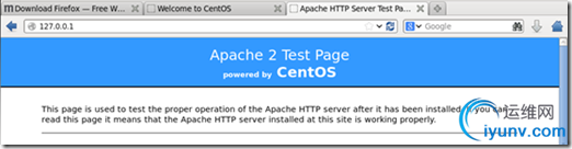

  启动服务:
  [iyunv@localhost ~]# /usr/local/apache2/bin/apachectl start
  [iyunv@localhost ~]# netstat -tulnp | grep http
  [iyunv@localhost ~]# iptables -I INPUT -p tcp --dport 80 -j ACCEPT
  [iyunv@localhost ~]# service iptables save
  安装后,Apache会提供名为apachectl启动脚本。脚本在/usr/local/apache2/bin目录下,该脚本用来进行Apache httpd的启动、关闭以及测试功能,具体的参数见下表。

  没有修改配置文件的情况下用start启动httpd程序,可能返回错误提示:
  AH00558: httpd: Could not reliably determine the server's fully qualified domain name, using localhost.localdomain. Set the 'ServerName' directive globally to suppress this message
  (98)Address already in use: AH00072: make_sock: could not bind to address [::]:80
  (98)Address already in use: AH00072: make_sock: could not bind to address 0.0.0.0:80
  no listening sockets available, shutting down
  AH00015: Unable to open logs
  但是确实服务已经启动了。
