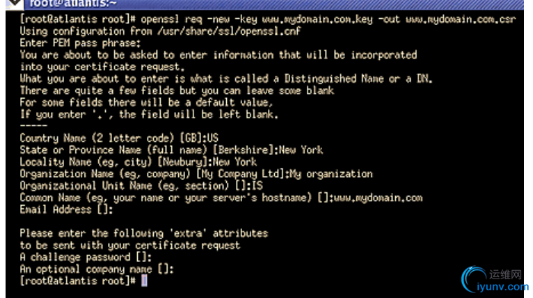

  2.   生成 CSR 文件 Generate the CSR  请使用以下命令来生成CSR Please type the following command at the prompt:
  openssl req -new -key www.mydomain.com.key -out www.mydomain.com.csr
  如果提示“Unable to load config info from /usr/local/ssl/openssl.cnf ”, 则加上一个指定openssl.cnf 路径的参数: openssl req -new -config openssl.cnf -key www.mydomain.com.key -out  www.mydomain.com.csr
  此命令将提示您输入X.509证书所要求的字段信息,包括国家(中国添CN)、省 份、所在城市、单位名称、单位部门名称(可以不填直接回车)。请注意: 除国 家缩写必须填CN外,其余都可以是英文或中文。
  This command will prompt you for the X.509 attributes of your certificate.  Enter your country, state or province and locality or city. You should  enter the company name as it appears on your official company registration  documents. The organization unit is optional, we verify and authenticate  the company name and not the organization unit. To skip the organization  unit (OU) field please press enter on your keyboard.
  请输入您要申请SSL证书的域名,如果您需要为www.domain.com申请SSL证书 就不能只输入domain.com。SSL证书是严格绑定域名的。   The term "Common Name" is X.509 speak for the name that distinguishes the  certificate best, and ties it to your Organization. Enter your exact host  and domain name that you wish to secure. Example: If you wish to secure  www.mydomain.com, then you will need to enter the exact host (www) and  domain name (mydomain.com) in this field. If you enter mydomain.com then  the certificate issued to you will only work error free on  https://mydomain.com. It will cause a certificate mismatch error when you  or your users access the domain via https:// www.mydomain.com.
  注意: Common name 一定得写好  nihao.com  就不能是 www.nihao.com
  请不要输入Email、口令(challenge password)和可选的公司名称,直接打回车 即可。   Please do not enter your email address, challenge password or an optional  company name when generating the CSR.
  您现在已经成功生成了密钥对,私钥文件:www.mydomain.com.key 保存在您的 服务器中, 请把CSR文件:www.mydomain.com.csr 发给Willrey/Thawte即可, CSR文件格式如下图所示。   You have now created a public/private key pair. The private key  (www.mydomain.com.key) is stored locally on your machine and is used for  decryption. The public portion is sent to thawte in the form of a  Certificate Signing Request, and will be used by your users to encrypt  the data they send to your site. The Certificate Signing Request (CSR)  looks something like this:
