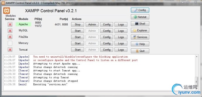

  我现在的XAMP版本是xampp-win32-1.8.3-1-VC11-installer(下载)
  Apache启动提示
  10:33:43  [Apache]Problem detected!
  10:33:43  [Apache]Port 80 in use by "Unable to open process" with PID 4!
  10:33:43  [Apache]Apache WILL NOT start without the configured ports free!
  10:33:43  [Apache] Youneed to uninstall/disable/reconfigure the blocking application
  10:33:43  [Apache] orreconfigure Apache and the Control Panel to listen on a different port
  10:33:43  [Apache]Port 443 in use by ""C:\Program Files (x86)\VMware\VMwareWorkstation\vmware-hostd.exe" -u "C:\ProgramData\VMware\hostd\config.xml""with PID 5728!

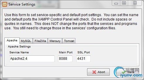

  红色标注部分设置了其实端口,依次修改成
  apache_server_port=8088
  apache_server_ssl_port=4431

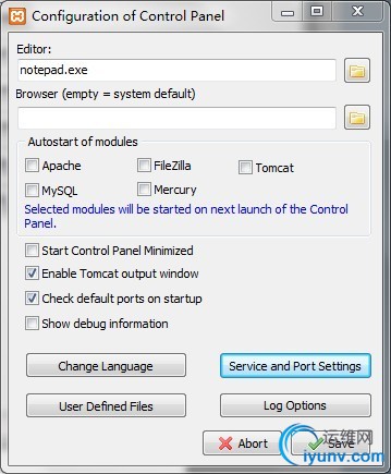

  1、打开xampp-control.ini,找到
  [ServicePorts]
  Apache=80
  ApacheSSL=443
  MySQL=3306
  FileZilla=21
  FileZillaAdmin=14147
  Mercury1=25
  Mercury2=79
  Mercury3=105
  Mercury4=106
  Mercury5=110
  Mercury6=143
  Mercury7=2224
  TomcatHTTP=8080
  TomcatAJP=8009
  Tomcat=8005
  修改成
  Apache=8088
  ApacheSSL=4431
  修改它。。。。
  修改成8088,4431
  重新启动,搞定。不容易啊。
