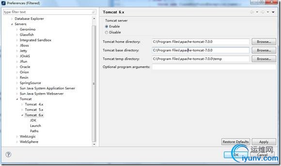

  下载Tomcat7.0后,和MyEclipse进行整合,MyEclipse配置Tomcat7.0如下图

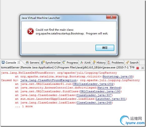

  发现在启动的时候报了一个错误
  java.lang.NoClassDefFoundError: org/apache/juli/logging/LogFactory
      at org.apache.catalina.startup.Bootstrap.(Bootstrap.java:55)
  Caused by: java.lang.ClassNotFoundException: org.apache.juli.logging.LogFactory
      at java.net.URLClassLoader$1.run(URLClassLoader.java:202)
      at java.security.AccessController.doPrivileged(Native Method)
      at java.net.URLClassLoader.findClass(URLClassLoader.java:190)
      at java.lang.ClassLoader.loadClass(ClassLoader.java:307)
      at sun.misc.Launcher$AppClassLoader.loadClass(Launcher.java:301)
      at java.lang.ClassLoader.loadClass(ClassLoader.java:248)
      ... 1 more
  Exception in thread "main"
