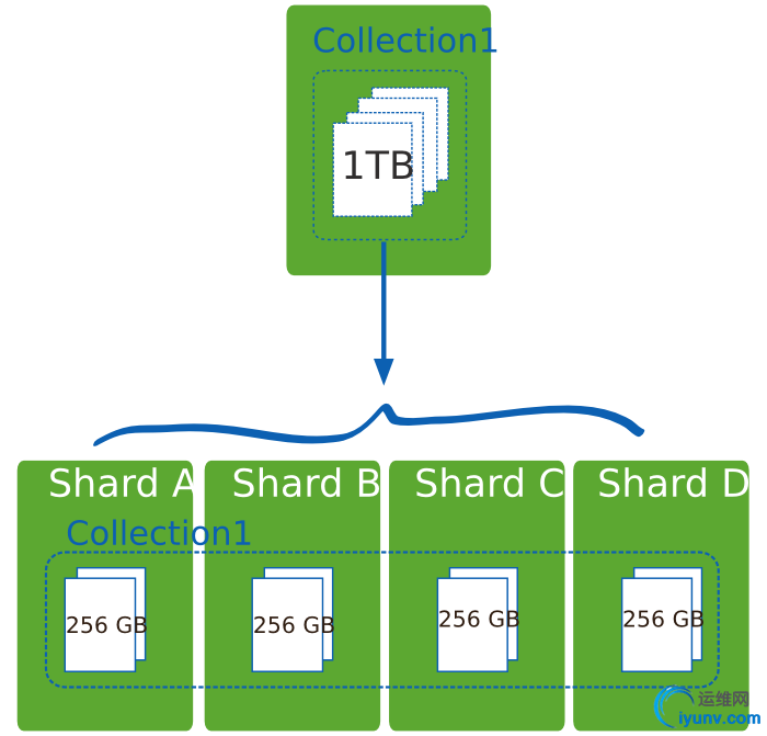

  • 使用分片减少了每个分片存储的数据.
    举例来说,如果一个数据库有1TB数据,并有4个分片,则每个分片只需要存储256GB数据,如果数据库有40个分片,则每个分片只需要存储25GB数据.

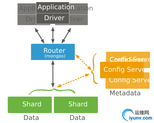

Diagram of a sample sharded cluster for production purposes. Contains exactly 3 config servers, 2 or more mongos query routers, and at least 2 shards. The shards are replica sets.
集群拥有以下组件: 分片, 分发路由,:term:配置服务器 <config server>.
Shards store the data. To provide high availability and data consistency, in a production sharded cluster, each shard is a replica set [1]. For more information on replica sets, see Replica Sets.
Query Routers, or mongos instances, interface with client applications and direct operations to the appropriate shard or shards. The query router processes and targets operations to shards and then returns results to the clients. A sharded cluster can contain more than one query router to divide the client request load. A client sends requests to one query router. Most sharded cluster have many query routers.
Config servers store the cluster’s metadata. This data contains a mapping of the cluster’s data set to the shards. The query router uses this metadata to target operations to specific shards. Production sharded clusters have exactly 3 config servers.

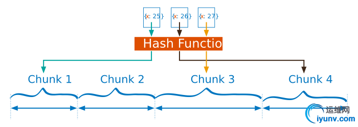

基于哈希的分片对于 基于哈希的分片 ,MongoDB计算一个字段的哈希值,并用这个哈希值来创建数据块.
在使用基于哈希分片的系统中,拥有”相近”片键的文档 很可能不会 存储在同一个数据块中,因此数据的分离性更好一些.
Diagram of the hashed based segmentation.

集群组件Sharded clusters implement sharding. A sharded cluster consists of the following components:
  • 分片
  • 分片是存储了一个集合部分数据的MongoDB实例,每个分片是单独的 mongod 或者是 replica set .在生产环境中,所有的分片都应该是复制集.参见 分片 获得更多信息.
  • 配置服务器
  • 每个:ref:配置服务器 <sharding-config-server>`都是存储了集群元信息的 :program:`mongod.元信息存储了 数据块 对分片的映射,参见 配置服务器.获得更多信息.
  • 分发路由
Diagram of a sharded cluster.
