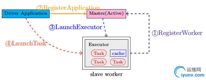

  组成cluster的两大元素即Master和Worker。slave worker可以有1到多个,这些worker都处于active状态。
  Driver Application可以运行在Cluster之内,也可以在cluster之外运行,先从简单的讲起即Driver Application独立于Cluster。那么这样的整体框架如下图所示,由driver,master和多个slave worker来共同组成整个的运行环境。

步骤1 运行master
$SPARK_HOME/sbin/start_master.sh
  在start_master.sh中最关键的一句就是
"$sbin"/spark-daemon.sh start org.apache.spark.deploy.master.Master 1 --ip $SPARK_MASTER_IP --port $SPARK_MASTER_PORT --webui-port $SPARK_MASTER_WEBUI_PORT
  检测Master的jvm进程
root     23438     1 67 22:57 pts/0    00:00:05 /opt/java/bin/java -cp :/root/working/spark-0.9.1-bin-hadoop2/conf:/root/working/spark-0.9.1-bin-hadoop2/assembly/target/scala-2.10/spark-assembly_2.10-0.9.1-hadoop2.2.0.jar -Dspark.akka.logLifecycleEvents=true -Djava.library.path= -Xms512m -Xmx512m org.apache.spark.deploy.master.Master --ip localhost --port 7077 --webui-port 8080
  Master的日志在$SPARK_HOME/logs目录下
步骤2 运行worker,可以启动多个
./bin/spark-class org.apache.spark.deploy.worker.Worker spark://localhost:7077
  worker运行时,需要注册到指定的master url,这里就是spark://localhost:7077.
  Master侧收到RegisterWorker通知,其处理代码如下
case RegisterWorker(id, workerHost, workerPort, cores, memory, workerUiPort, publicAddress) =>
logInfo("Registering worker %s:%d with %d cores, %s RAM".format(
workerHost, workerPort, cores, Utils.megabytesToString(memory)))
if (state == RecoveryState.STANDBY) {
// ignore, don't send response
} else if (idToWorker.contains(id)) {
sender ! RegisterWorkerFailed("Duplicate worker ID")
} else {
val worker = new WorkerInfo(id, workerHost, workerPort, cores, memory,
sender, workerUiPort, publicAddress)
if (registerWorker(worker)) {
persistenceEngine.addWorker(worker)
sender ! RegisteredWorker(masterUrl, masterWebUiUrl)
schedule()
} else {
val workerAddress = worker.actor.path.address
logWarning("Worker registration failed. Attempted to re-register worker at same " +
"address: " + workerAddress)
sender ! RegisterWorkerFailed("Attempted to re-register worker at same address: "
+ workerAddress)
步骤3 运行Spark-shell
MASTER=spark://localhost:7077 $SPARK_HOME/bin/spark-shell
  spark-shell属于application,有关appliation的运行日志存储在$SPARK_HOME/works目录下
  spark-shell作为application,在Master侧其处理的分支是RegisterApplication,具体处理代码如下。
case RegisterApplication(description) => {
} else {
logInfo("Registering app " + description.name)
val app = createApplication(description, sender)
registerApplication(app)
logInfo("Registered app " + description.name + " with ID " + app.id)
persistenceEngine.addApplication(app)
sender ! RegisteredApplication(app.id, masterUrl)
schedule()
  每当有新的application注册到master,master都要调度schedule函数将application发送到相应的worker,在对应的worker启动相应的ExecutorBackend. 具体代码请参考Master.scala中的schedule函数,代码就不再列出。
步骤4 结果检测
root     23752 23745 21 23:00 pts/0    00:00:25 /opt/java/bin/java -cp :/root/working/spark-0.9.1-bin-hadoop2/conf:/root/working/spark-0.9.1-bin-hadoop2/assembly/target/scala-2.10/spark-assembly_2.10-0.9.1-hadoop2.2.0.jar -Djava.library.path= -Xms512m -Xmx512m org.apache.spark.repl.Main
root     23986 23938 25 23:02 pts/2    00:00:03 /opt/java/bin/java -cp :/root/working/spark-0.9.1-bin-hadoop2/conf:/root/working/spark-0.9.1-bin-hadoop2/assembly/target/scala-2.10/spark-assembly_2.10-0.9.1-hadoop2.2.0.jar -Dspark.akka.logLifecycleEvents=true -Djava.library.path= -Xms512m -Xmx512m org.apache.spark.deploy.worker.Worker spark://localhost:7077
root     24047 23986 34 23:02 pts/2    00:00:04 /opt/java/bin/java -cp :/root/working/spark-0.9.1-bin-hadoop2/conf:/root/working/spark-0.9.1-bin-hadoop2/assembly/target/scala-2.10/spark-assembly_2.10-0.9.1-hadoop2.2.0.jar -Xms512M -Xmx512M org.apache.spark.executor.CoarseGrainedExecutorBackend akka.tcp://spark@localhost:40053/user/CoarseGrainedScheduler 0 localhost 4 akka.tcp://sparkWorker@localhost:53568/user/Worker app-20140511230059-0000
  从运行的进程之间的关系可以看出,worker和master之间的连接建立完毕之后,如果有新的driver application连接上master,master会要求worker启动相应的ExecutorBackend进程。此后若有什么Task需要运行,则会运行在这些Executor之上。可以从以下的日志信息得出此结论,当然看源码亦可。

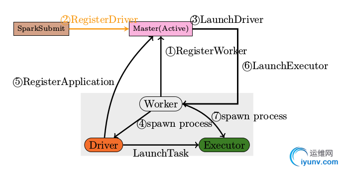

在cluster中运行Driver Application
  上一节之所以写到类的动态加载与反射都是为了谈这一节的内容奠定基础。
  将Driver application部署到Cluster中,启动的时序大体如下图所示。
  • 首先启动Master,然后启动Worker
  • 使用”deploy.Client"将Driver Application提交到Cluster中
./bin/spark-class org.apache.spark.deploy.Client launch
[client-options] \
[application-options]
  • Master在收到RegisterDriver的请求之后,会发送LaunchDriver给worker,要求worker启动一个Driver的jvm process
  • Driver Application在新生成的JVM进程中运行开始时会注册到master中,发送RegisterApplication给Master
  • Master发送LaunchExecutor给Worker,要求Worker启动执行ExecutorBackend的JVM Process
  • 一当ExecutorBackend启动完毕,Driver Application就可以将任务提交到ExecutorBackend上面执行,即LaunchTask指令
提交侧的代码,详见deploy/Client.scala

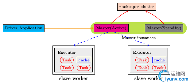

Standalone模式下HA的实现
  Spark在standalone模式下利用zookeeper来实现了HA机制,这里所说的HA是专门针对Master节点的,因为上面所有的分析可以看出Master是整个cluster中唯一可能出现单点失效的节点。
  采用zookeeper之后,整个cluster的组成如下图所示。
  为了使用zookeeper,Master在启动的时候需要指定如下的参数,修改conf/spark-env.sh, SPARK_DAEMON_JAVA_OPTS中添加如下选项。
System propertyMeaning
spark.deploy.recoveryModeSet to ZOOKEEPER to enable standby Master recovery mode (default: NONE).
spark.deploy.zookeeper.urlThe ZooKeeper cluster url (e.g., 192.168.1.100:2181,192.168.1.101:2181).
spark.deploy.zookeeper.dirThe directory in ZooKeeper to store recovery state (default: /spark).
实现HA的原理
  zookeeper提供了一个Leader Election机制,利用这个机制,可以实现HA功能,具体请参考zookeeper recipes
  在Spark中没有直接使用zookeeper的api,而是使用了curator,curator对zookeeper做了相应的封装,在使用上更为友好。
