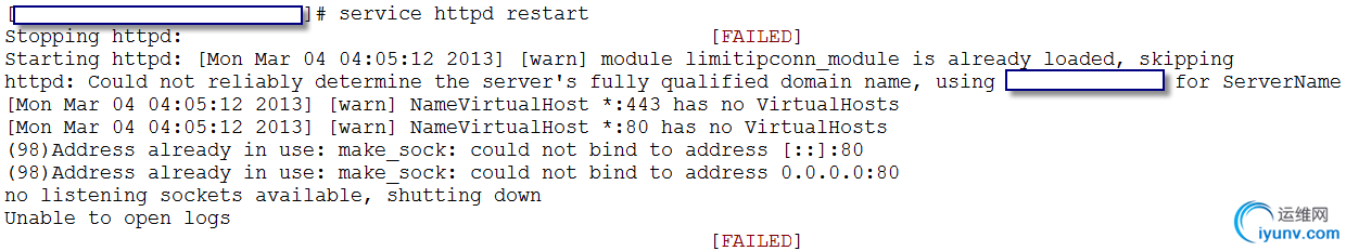

  现象:
  # service httpd restart
Stopping httpd:                                            [FAILED]
Starting httpd: [Mon Mar 04 04:05:12 2013] [warn] module limitipconn_module is already loaded, skipping
httpd: Could not reliably determine the server's fully qualified domain name, using Xfor ServerName
[Mon Mar 04 04:05:12 2013] [warn] NameVirtualHost *:443 has no VirtualHosts
[Mon Mar 04 04:05:12 2013] [warn] NameVirtualHost *:80 has no VirtualHosts
(98)Address already in use: make_sock: could not bind to address [::]:80
(98)Address already in use: make_sock: could not bind to address 0.0.0.0:80
no listening sockets available, shutting down
Unable to open logs
