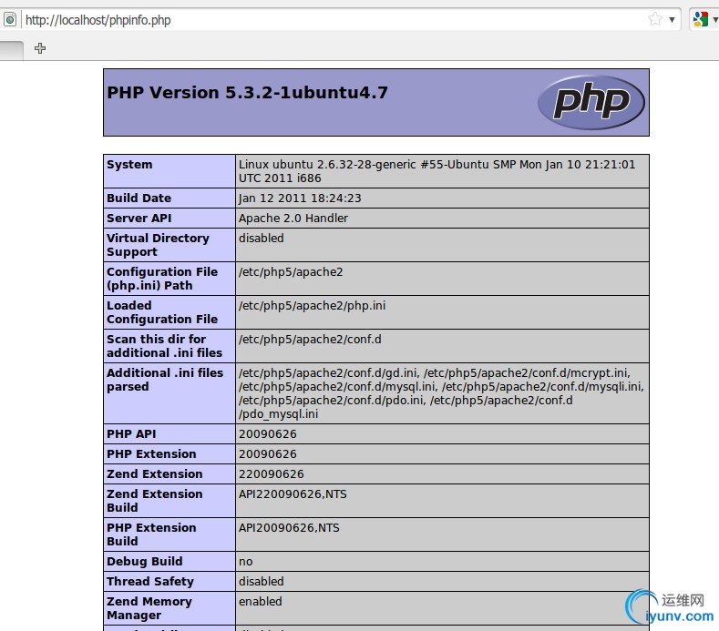

  To test PHP is installed, Type
sudo gedit /var/www/phpinfo.php
  in the terminal and type your ubuntu password if needed. It will open the phpinfo.php file in gedit.Type below code in the phpinfo.php file, save and exit it .
  Now open your favorite browser and type http://localhost/phpinfo.php in the address bar and press enter. If you will see the below page , then your php works fine.

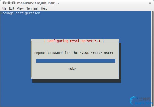

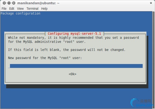

During the installation you will be prompted for a password.Choose something secure and type the password and hit enter .
  Repeat the password and press enter.

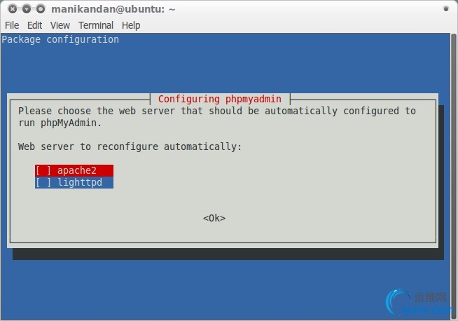

  During the installation you will be prompted for a webserver configuration.
Select
apache2
  (already selected)
press enter.

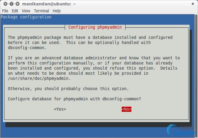

Now you will be promped for phpmyadmin configuration
  Select
No
  and press enter.

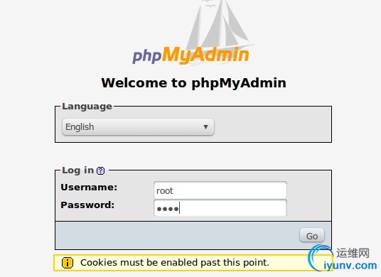

  Open your browser and type
http://localhost/phpmyadmin/
  Type your mysql root  username and password to login.
