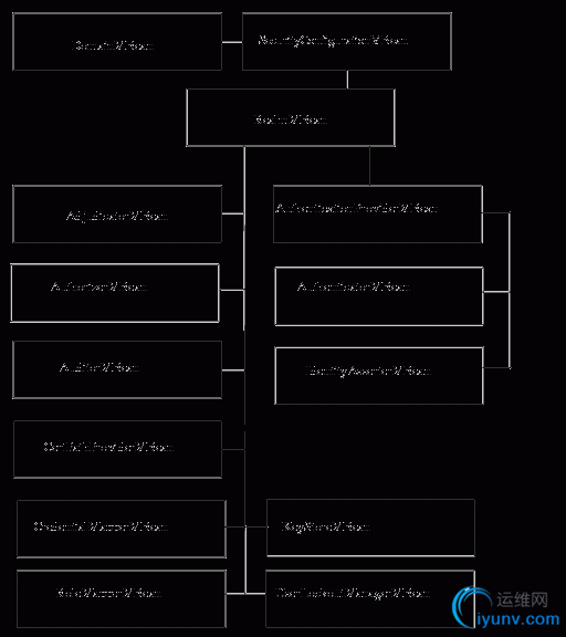

  0x2: Understanding the Hierarchy of Security MBeans
  Like other subsystems, the "WebLogic Server security framework" organizes its MBeans in a hierarchy that JMX clients can navigate without constructing JMX object names. However
1. the set of MBean types that are available in a security realm depends on which security providers you have installed in the realm
2. the set of services that each security provider enables depends on how the provider was created.
  tomcat使用层次结构的MBeans对安全域进行组织管理,每个Mbeans对应于不同方面的安全配置,程序员可以通过JMX Clients连接这些Mbeans,对tomcat的对应的安全配置进行动态的读写
security providers -> security realm(一个realm可以包含多个providers) -> MBean Proxy -> security service(APIS)
