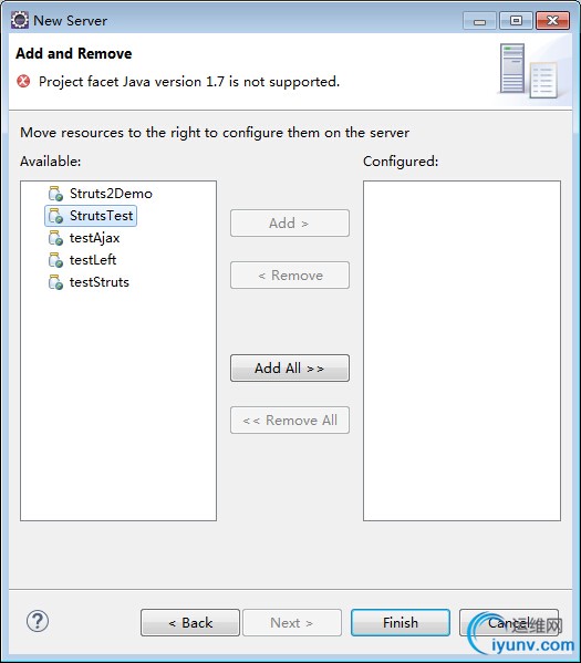

  当我添加7时,发现如下报错:
  Project facet java version 1.7 is not supported
