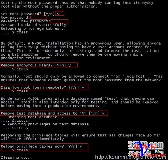

…初始化 MySQL 数据库: Installing MySQL system tables...OKFilling help tables...OKTo start mysqld at boot time you have to copysupport-files/mysql.server to the right place for your systemPLEASE REMEMBER TO SET A PASSWORD FOR THE MySQL root USER !To do so, start the server, then issue the following commands:/usr/bin/mysqladmin -u root password 'new-password'/usr/bin/mysqladmin -u root -h vmnode1 password 'new-password'Alternatively you can run:/usr/bin/mysql_secure_installationwhich will also give you the option of removing the testdatabases and anonymous user created by default.  This isstrongly recommended for production servers.See the manual for more instructions.You can start the MySQL daemon with:cd /usr ; /usr/bin/mysqld_safe &You can test the MySQL daemon with mysql-test-run.plcd /usr/mysql-test ; perl mysql-test-run.plPlease report any problems with the /usr/bin/mysqlbug script![确定]正在启动 mysqld:                                          [确定]Running mysql_secure_installation.Current root password for fresh installation is blank. So simple press enter.NOTE: RUNNING ALL PARTS OF THIS SCRIPT IS RECOMMENDED FOR ALL MySQLSERVERS IN PRODUCTION USE!  PLEASE READ EACH STEP CAREFULLY!In order to log into MySQL to secure it, we'll need the currentpassword for the root user.  If you've just installed MySQL, andyou haven't set the root password yet, the password will be blank,so you should just press enter here.Enter current password for root (enter for none):OK, successfully used password, moving on...Setting the root password ensures that nobody can log into the MySQLroot user without the proper authorisation.Set root password? [Y/n] yNew password:Re-enter new password:Password updated successfully!Reloading privilege tables..... Success!By default, a MySQL installation has an anonymous user, allowing anyoneto log into MySQL without having to have a user account created forthem.  This is intended only for testing, and to make the installationgo a bit smoother.  You should remove them before moving into aproduction environment.Remove anonymous users? [Y/n] y... Success!Normally, root should only be allowed to connect from 'localhost'.  Thisensures that someone cannot guess at the root password from the network.Disallow root login remotely? [Y/n] y... Success!By default, MySQL comes with a database named 'test' that anyone canaccess.  This is also intended only for testing, and should be removedbefore moving into a production environment.Remove test database and access to it? [Y/n] y- Dropping test database...... Success!- Removing privileges on test database...... Success!Reloading the privilege tables will ensure that all changes made so farwill take effect immediately.Reload privilege tables now? [Y/n] y... Success!Cleaning up...All done!  If you've completed all of the above steps, your MySQLinstallation should now be secure.Thanks for using MySQL!mysqld (pid  2691) 正在运行...MySQL service is already running.Prerequsite for ConVirt Management Server (CMS) installed.
说明:安装过程会安装mysql数据库,并输入mysql数据库root帐号密码。 230837805.jpg

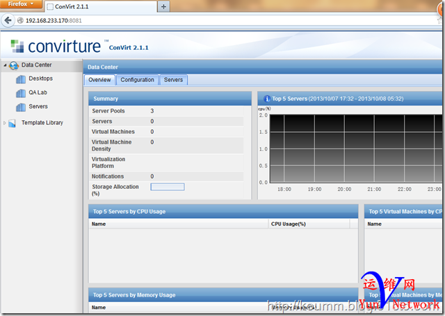

(8)打开convirt2.1.1http://192.168.233.170:8081
输入admin/admin
还需要在kvm虚拟主机上安装convirt-tools工具之后才能添加。

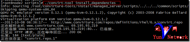

2.在KVM虚拟主机上安装convirt-tools工具
# wget http://www.convirture.com/downlo ... -tools-2.1.1.tar.gz# tar zxvf convirture-tools-2.1.1.tar.gz# cd convirture-tools/install/managed_server/scripts# ./convirt-tool install_dependencies# ./convirt-tool setup
3.在convirtcms上添加KVM虚拟主机添加KVM虚拟主机。
