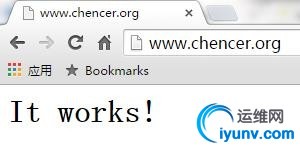

访问测试;

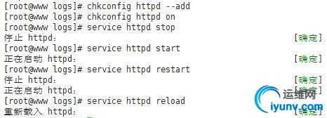

添加服务,测试脚本;
# chkconfig httpd –add
# chkconfig httpd on
# service httpd stop
# service httpd start
# service httpd restart
# service httpd reload
