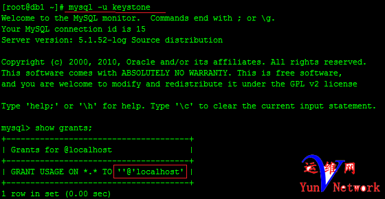

用空密码尝试登陆:
[iyunv@db1 ~]# mysql -u keystone
Welcome to the MySQL monitor.  Commands end with ; or g.
Your MySQL connection id is 14
Server version: 5.1.52-log Source distribution
Copyright (c) 2000, 2010, Oracle and/or its affiliates. All rights reserved.
This software comes with ABSOLUTELY NO WARRANTY. This is free software,
and you are welcome to modify and redistribute it under the GPL v2 license
Type 'help;' or 'h' for help. Type 'c' to clear the current input statement.
mysql> show databases;
| Database           |
| information_schema |
| test               |
2 rows in set (0.00 sec)
登陆成功,不过不能显示keystone数据库

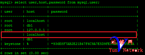

分析:
执行第三步前:
mysql> select user,host,password from mysql.user;
| user     | host      | password                                  |
| root     | localhost |                                           |
| root     | db1       |                                           |
| root     | 127.0.0.1 |                                           |
|          | localhost |                                           |
|          | db1       |                                           |
| keystone | %         | *936E8F7AB2E21B47F6C9A7E5D9FE14DBA2255E5A |
6 rows in set (0.00 sec)
mysql -u keystone -pkeystone使用的用户是keystone@localhost,此时的权限表里并没有明确匹配这一用户的授权,于是MySQL将优先查找host='localhost,'的权限,这里匹配到了''@'localhost'密码为空,而mysql -u keystone -pkeystone提交的密码是keystone,MySQL认为密码不匹配于是拒绝登陆.而mysql -u keystone使用空密码恰好能匹配上于是反而空密码能登陆,不过由于''@'localhost'不具有keystone数据库的访问权限,所以登陆后看不到keystone库。
为了安全考虑应该移除该权限,那么openstack初始化数据库时可以不用重复授权
