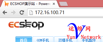

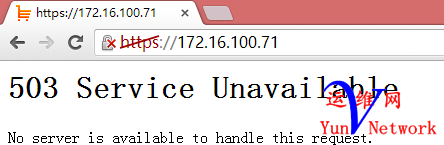

测试:
web4上停止httpd服务:
[iyunv@web4 ~]# service httpd stop
Stopping httpd:                                            [  OK  ]
https已不能访问(backend https-servers只定义了web4),但http仍能正常访问

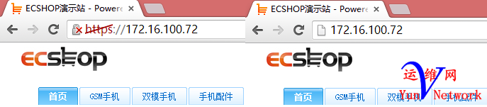

ha2上haproxy安装完毕后
[iyunv@ha1 ~]# scp /etc/haproxy/{haproxy.cfg,server.pem} 172.16.100.72:/etc/haproxy/
[iyunv@ha2 ~]# service haproxy start
Starting haproxy:                                          [  OK  ]
测试,

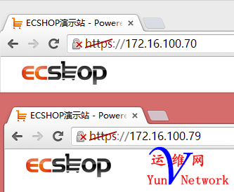

keepalived提供haproxy高可用
[iyunv@ha1 keepalived]# cat keepalived.conf
! Configuration File for keepalived
global_defs {
   notification_email {
         root@sanyu.com
   notification_email_from kanotify@sanyu.com
   smtp_connect_timeout 3
   smtp_server 127.0.0.1
   router_id LVS_DEVEL
vrrp_script chk_haproxy {
    script "killall -0 haproxy"
    interval 1
    weight 2
vrrp_script chk_mantaince_down {
   script "[[ -f /etc/keepalived/down ]] && exit 1 || exit 0"
   interval 1
   weight 2
vrrp_instance VI_1 {
    interface eth0
    state MASTER  # BACKUP for slave routers
    priority 101  # 100 for BACKUP
    virtual_router_id 70
    garp_master_delay 1
    authentication {
        auth_type PASS
        auth_pass password
    track_interface {
       eth0
    virtual_ipaddress {
        172.16.100.70/16 dev eth0 label eth0:0
    track_script {
        chk_haproxy
        chk_mantaince_down
vrrp_instance VI_2 {
    interface eth0
    state BACKUP  # BACKUP for slave routers
    priority 100  # 100 for BACKUP
    virtual_router_id 79
    garp_master_delay 1
    authentication {
        auth_type PASS
        auth_pass password
    track_interface {
       eth0
    virtual_ipaddress {
        172.16.100.79/16 dev eth0 label eth0:1
    track_script {
        chk_haproxy
        chk_mantaince_down
[iyunv@ha1 keepalived]# diff keepalived.conf keepalived.conf.ha2
25,26c25,26
<     state MASTER  # BACKUP for slave routers
<     priority 101  # 100 for BACKUP
48,49c48,49
<     state BACKUP  # BACKUP for slave routers
<     priority 100  # 100 for BACKUP
[iyunv@ha1 ~]# scp /etc/keepalived/keepalived.conf.ha2 172.16.100.72:/etc/keepalived/keepalived.conf
[iyunv@ha1 ~]# service keepalived start
Starting keepalived:                                       [  OK  ]
[iyunv@ha2 ~]# service keepalived start

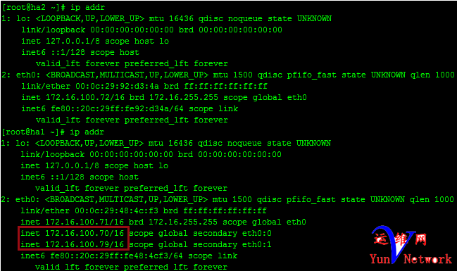

故障转移:
[iyunv@ha2 ~]# service haproxy stop
Shutting down haproxy:                                     [  OK  ]
vip漂到了ha1上
