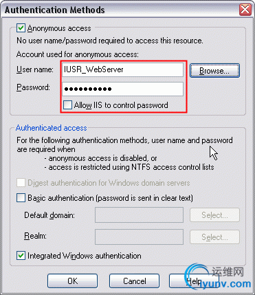

Synchronize the IUSR Account
  The second solution is to create two identical accounts with
identical passwords on both machines. This will work, as both accounts
will use the same password hash. So, at run-time, when WebServer tries to write to FileServer, the machine FileServer will recognize the account that WebServer presents, and will allow it to write to the folder where the Web files reside.
How to Configure Your Servers for Synchronized Accounts?
  • On WebServer, open up User Management (either under Computer Management, or within Active Directory) and change the password for the IUSR_WebServer account. Give it a strong password, and make sure that the password does not automatically expire.
  • In IIS on WebServer, change the password that the IUSR_WebServer account uses. Also disable the feature Allow IIS to control password. To do this, open the Internet Information Services Management Console which you'll find in the Administrative Tools menu on the Start Menu or in the Control Panel.
    Expand your server in the tree on the left until you see the Web site
    or Virtual Directory you want to configure. Right click the site or
    directory and choose Properties.
    Switch to the Directory Security tab and click the Edit... button in the Anonymous access and authentication control area. Make sure Anonymous access is enabled, and provide the strong password you set for the IUSR_WebServer account in step 1. The dialog box should look similar to this one:
    Figure 2 - Anonymous Authentication with a Synchronized IUSR Account
  • On FileServer, create a new account and name it IUSR_WebServer. Notice that the account ends with WebServer, not with FileServer. Give this account the same password as you gave to IUSR_WebServer in step 1.
  • Give the IUSR_WebServer account on the FileServer machine the required privileges to write to the directory that holds your files
  • Browse to your site. IIS will use the anonymous account IUSR_WebServer for any requests made to IIS. The mirrored account on FileServer makes sure that your IIS is allowed to write files to the folder on FileServer.

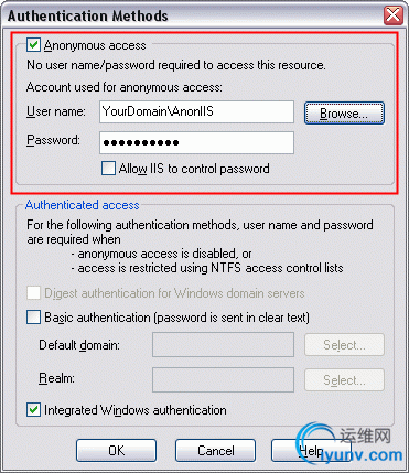

Using a Domain Account in IIS
  Instead of using the mirrored IUSR account, you can create a brand
new account that is specifically used for IIS anonymous access. Since
this account lives in your (Active Directory) domain, it's easy to give
it the required permissions on both WebServer and FileServer.
You may be tempted to use the the Administrator account for that, but
it's recommended not to that. Using the Administrator account for IIS is
a great security risk as it allows IIS, and all pages being served by
it, to operate with Administrator privileges.
How to Configure Your Servers for a Domain Account?
  To create the domain account follow these steps:
  • On WebServer, open up Active Directory Users and Computers (or other User Management software you may have) and create a new account. Call this account AnonIIS
    for example, although any name will do. Give it a strong password, and
  • In IIS on WebServer, change the user account and password that is used for anonymous account uses. Also disable the feature Allow IIS to control password. To change both settings, open the Internet Information Services Management Console which you'll find in the Administrative Tools menu on the Start Menu or in the Control Panel.
    is enabled, and provide the account name and strong password you
    created in step 1. The dialog box should look similar to this one:
    Figure 3 - Anonymous Authentication Using a Network Account
  • On FileServer, give the YourDomain\AnonIIS account the required privileges to write to the directory that holds your files.
  • Browse to your site. IIS will use the anonymous account you set
    in step2 for any requests made to IIS. That domain account has also
    access rights to the folder on FileServer so IIS is allowed to write to files in that folder.

  • On the Item Name Properties dialog box where Item Name is the name of the item that you selected, click the Directory Security tab.
    NOTE: If the selected item is an individual file, click the File Security tab.
  • Under Anonymous access and authentication control, click Edit.
  • Click to select the Anonymous access check box to turn on anonymous access. To turn off anonymous access, click to clear this check box.
    NOTE: If you turn off anonymous access, you need to configure some form of authenticated access.
    • To change the account that is used for anonymous access to this resource, click Edit next to Account used for anonymous access.
    • In the Anonymous User Account dialog box, click the user account that you want to use for anonymous access.
    • Click to clear the Allow IIS to control password check box if you want to use the Windows LogonUser() API for user authentication.
      NOTE:
      By turning this password control option off, this forces IIS to use
      normal authentication and to log the account on locally. You should turn
      this option off if users experience difficulty accessing resources such
      as files or Microsoft Access databases on a network computer.
    • Click OK.
