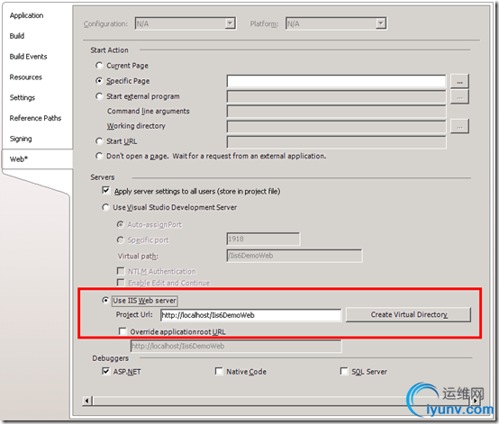

  To make this easy, start Visual Studio and create a new ASP.NET MVC Web Application Project on the machine with IIS 6. If your IIS 6 machine is on a different machine, you can skip this step. We can deploy the site to the machine later.
  After you create the project, right click the project and select Properties. The project properties editor will open up. Select the Web tab and selectUse IIS Web Server. Click on the image for a full size view.
  In the project URL, I gave it a virtual application name of Iis6DemoWeb and then checked Create Virtual Directory. A dialog box should appear and you should now have an IIS virtual application (note this is different than a virtual directory, as indicated by the gear looking icon) under your Default Web Site.

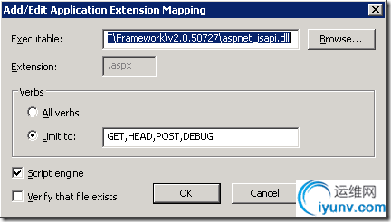

  It might differ on your machine. One easy way to find out is to find the .aspx extension in the list and double click it to bring up the mapping dialog.
  Now you can copy the path in the Executable text box to your clipboard. This is the path you’ll want to map .mvc to.
  Click Cancel to go back to the Application Configuration dialog and then click Add which will bring up an empty Add/Edit Application Extension Mapping dialog.
  Fill in the fields with the exact same values as you saw for .aspx, except the extension should be “.mvc” without the quotes. Click OK and you’re done with the mapping.

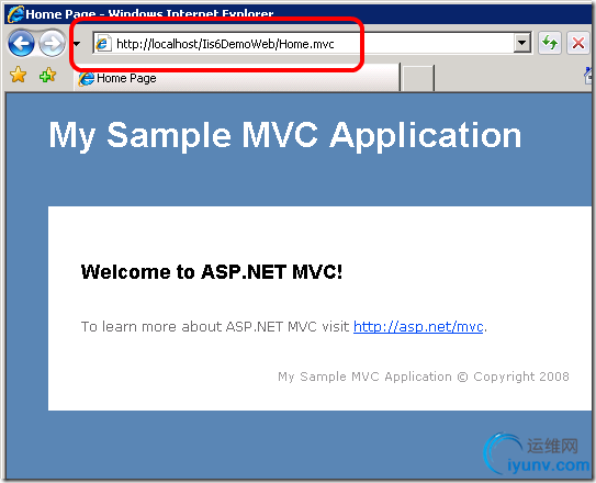

  Now, I can hit CTRL+F5 (or browse my website) and I should see the following home page.
  And about page.
  Notice that the URLs contain the .mvc extension.

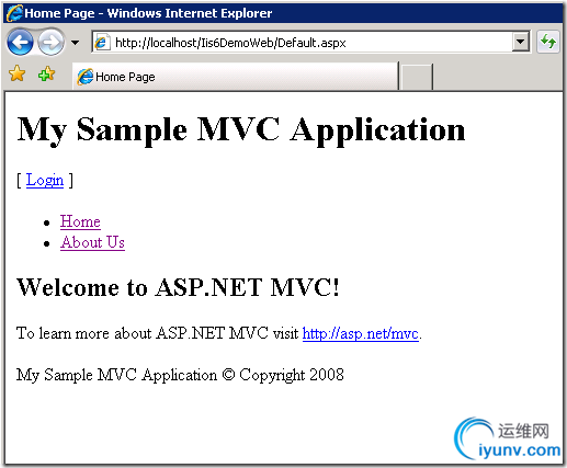

  Of course, you’re going to want to be able to navigate to the web root for your project. Notice what happens when you navigate to /Iis6DemoWeb.
  This is a bug in the Default.aspx.cs file included with our default template which I discovered as I was writing this walkthrough. We’ll fix it right away, but I can provide the fix here as it’s insanely easy.
  Note: If you received a File Not Found error when visiting the root, then you might not have Default.aspx mapped as a default document. Follow these steps to add Default.aspx as a default document.
  As I’ve written before, this file is necessary for IIS 6, IIS 7 Classic Mode, and pre SP1 Cassini, but not IIS 7 Integrated. So if you’re using Cassini with Visual Studio 2008 SP1 and deploying to IIS 7 Integrated, you can delete Default.aspxand its sub-files.
  In the meanwhile, the fix is to make the following change.
  Change:
HttpContext.Current.RewritePath(Request.ApplicationPath);
To
HttpContext.Current.RewritePath(Request.ApplicationPath, false);
If you created your website in the IIS root rather than a virtual application, you would never have noticed this issue. But in the virtual application, the URL to the stylesheet rendered contained the virtual application name, when it shouldn’t. Changing the second argument to false fixes this.
