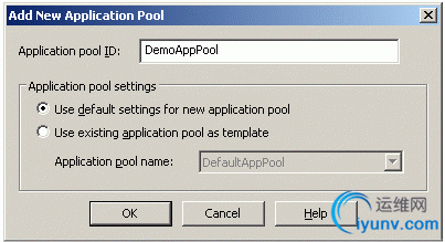

  To create a new application pool from scratch, right-click on the Application Pools node from the tree view and select New->Application Pool from the context menu. You will be presented with the following screen, where you need to enter a name for the application pool.
  When creating a new application, you also have the option of inheriting the settings from an existing application pool. For example, if you want your new application pool to inherit the settings from the DefaultAppPool, you can do that by selecting the option Use existing application pool as a template in the above screen. After you pick this option, the Application Pool name dropdown box will be enabled from where you can select an existing application pool.
  After the pool is created, you can save the settings of the application pool to an external XML file any time by right-clicking the application pool and selecting the option All Tasks->Save Configuration to a File that is available from the context menu. This is an extremely useful feature that makes it possible for you to easily recreate the same application pool on the same server or on a different server with minimal effort.
