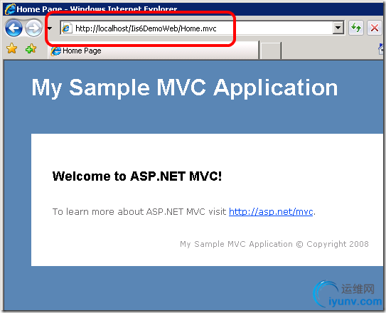

  Now, I can hit CTRL+F5 (or browse my website) and I should see the following home page.

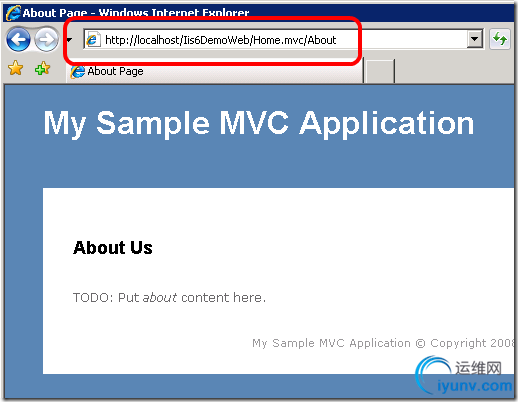

  And about page.
  Notice that the URLs contain the .mvc extension.

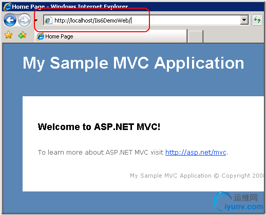

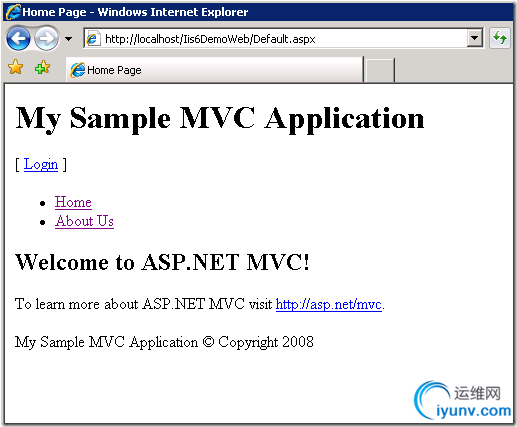

  Of course, you’re going to want to be able to navigate to the web  root for your project. Notice what happens when you navigate to /Iis6DemoWeb.
  This is a bug in the Default.aspx.cs file included with our  default template which I discovered as I was writing this walkthrough.  We’ll fix it right away, but I can provide the fix here as it’s insanely  easy.
  Note: If you received a File Not Found error when visiting the  root, then you might not have Default.aspx mapped as a default document.  Follow these steps to add Default.aspx as a default document.
  As I’ve written before,  this file is necessary for IIS 6, IIS 7 Classic Mode, and pre SP1  Cassini, but not IIS 7 Integrated. So if you’re using Cassini with  Visual Studio 2008 SP1 and deploying to IIS 7 Integrated, you can delete  Default.aspx and its sub-files.
  In the meanwhile, the fix is to make the following change.
  Change:
HttpContext.Current.RewritePath(Request.ApplicationPath);  To
HttpContext.Current.RewritePath(Request.ApplicationPath, false);  If you created your website in the IIS root rather than  a virtual application, you would never have noticed this issue. But in  the virtual application, the URL to the stylesheet rendered contained  the virtual application name, when it shouldn’t. Changing the second  argument to false fixes this.

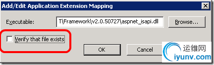

  This brings up the wildcard application mapping dialog. Enter the path to the aspnet_isapi.dll. You can follow the trick we mentioned earlier for getting this path.
  Don’t forget to uncheck the Verify that file exists checkbox! This is one of the most common mistakes people make.

  Now when you browse your site, your URLs will not have a file extension as you can see in the following screenshots.
