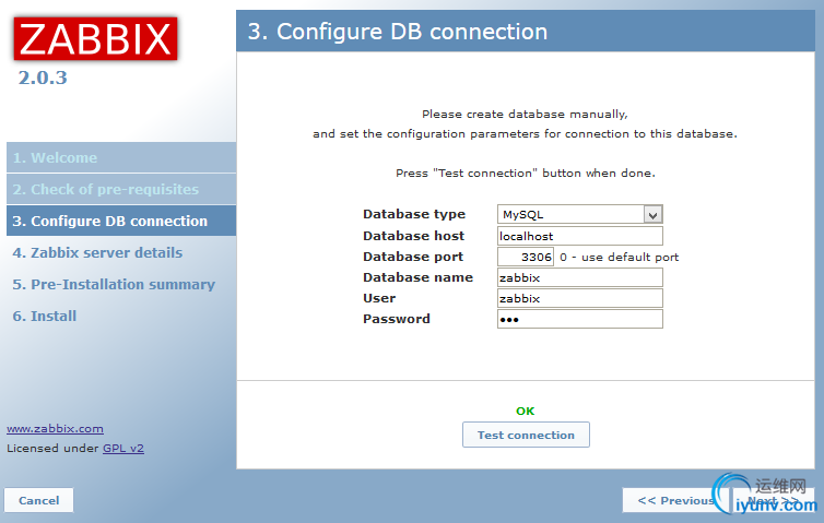

  # mysql -uroot -p
  mysql> create database zabbix;
  Query OK, 1 row affected (0.17sec)
  mysql> grant all on zabbix.* to zabbix@'localhost' identified by '123';
  Query OK, 0 rows affected (0.14sec)
  mysql> flush privileges;
  Query OK, 0 rows affected (0.09sec)
  mysql> quit

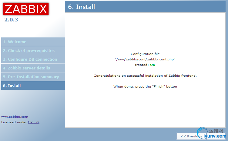

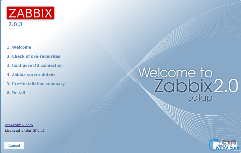

  浏览器输入http://IP/zabbix

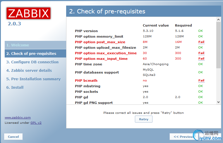

  # pwd
  /usr/src/lamp/php-5.3.10/ext
  # cd bcmath/
  # phpize
  Configuring for:
  PHP Api Version:         20090626
  Zend Module Api No:      20090626
  Zend Extension Api No:   220090626
  # ./configure
  # make && make install
  cp ./.libs/bcmath.so/usr/src/lamp/php-5.3.10/ext/bcmath/modules/bcmath.so
  Installing sharedextensions:    /usr/local/lib/php/extensions/no-debug-non-zts-20090626/
  # pwd
  /usr/src/lamp/php-5.3.10/ext/gettext
  # phpize
  Configuring for:
  # ./configure && make && make install
  cp ./.libs/gettext.so /usr/src/lamp/php-5.3.10/ext/gettext/modules/gettext.so
  # vim /usr/local/lib/php.ini
  # grep -v '^;' /usr/local/lib/php.ini | grep \
  -E 'post_max|max_execution|max_input|bcmath.so|gettext.so'
  max_execution_time= 300
  max_input_time= 300
  post_max_size= 16M
  extension=bcmath.so
  extension=gettext.so
  # /etc/init.d/apache restart
  刷新网页即可
  4和5两步这里不再截图

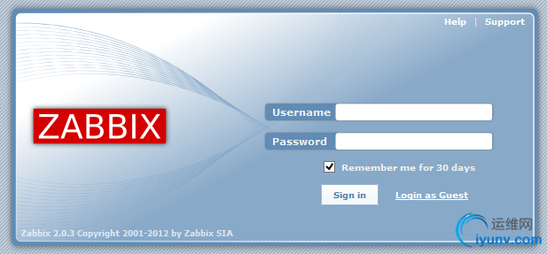

  默认user:admin
  password:zabbix

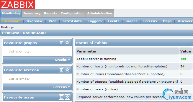

  登陆之后就可以看到zabbix的web主界面了
  可以修改语言为中文
  保存即可!强烈建议使用英文界面!!!
