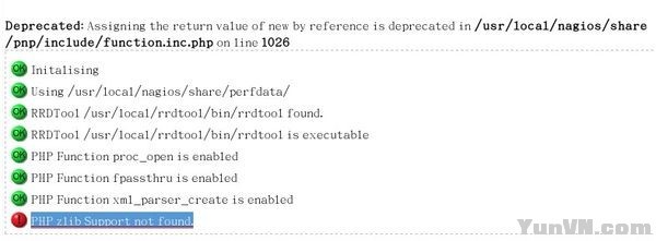

gd及zlib等都已安装,报错截图如下:
重新编译安装php 加上zlib的支持
[iyunv@test1 php-5.2.9]#  ./configure --prefix=/usr/local/php --with-apxs2=/usr/local/apache2/bin/apxs  --with-gd --with-freetype-dir --with-jpeg-dir --with-png-dir --with-zlib --enable-sockets
