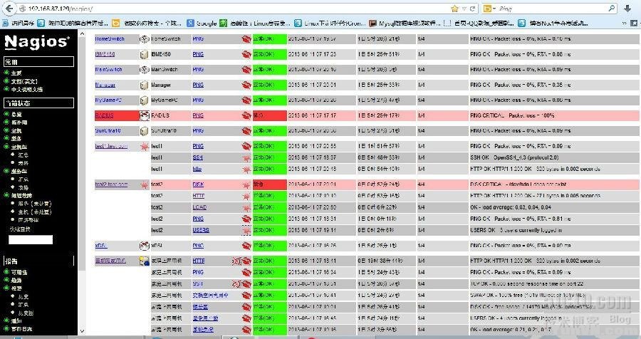

(5)测试和启动nagios服务
排错
nrpe Connection refused by host
[iyunv@test2 ~]# vim /usr/local/nagios/etc/nrpe.cfg
server_address=0.0.0.0
allowed_hosts=127.0.0.1,192.168.87.129,192.168.87.135
[iyunv@test2 ~]# netstat -antup|grep 5666
tcp        0      0 0.0.0.0:5666                0.0.0.0:*                   LISTEN      1093/nrpe
