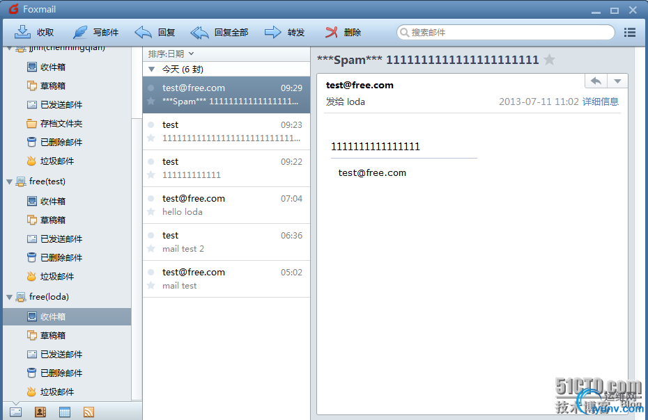

  (3).垃圾邮件的测试
[iyunv@mail ~]#  cd /usr/share/doc/spamassassin-3.3.1/
[iyunv@mail spamassassin-3.3.1]# sendmail test@free.com < sample-spam.txt
[iyunv@mail spamassassin-3.3.1]# tail -f /var/log/maillog
Jul 11 09:15:46 mail postfix/cleanup[17529]: 6AB1E23776: message-id=<GTUBE1.1010101@example.net>
Jul 11 09:15:46 mail postfix/qmgr[17492]: 6AB1E23776: from=<root@free.com>, size=1657, nrcpt=1 (queue active)
Jul 11 09:15:46 mail amavis[17520]: (17520-01) Passed SPAM {RelayedTaggedInbound,Quarantined}, <root@free.com> -> <test@free.com>, quarantine: spam-rnWvh9AXIRB2.gz, Message-ID: <GTUBE1.1010101@example.net>, mail_id: rnWvh9AXIRB2, Hits: 1005.069, size: 933, queued_as: 6AB1E23776, 2403 ms
Jul 11 09:15:46 mail postfix/smtp[17533]: D927923774: to=<test@free.com>, relay=127.0.0.1[127.0.0.1]:10024, delay=2.7, delays=0.21/0.07/0.02/2.4, dsn=2.0.0, status=sent (250 2.0.0 from MTA(smtp:[127.0.0.1]:10025): 250 2.0.0 Ok: queued as 6AB1E23776)\

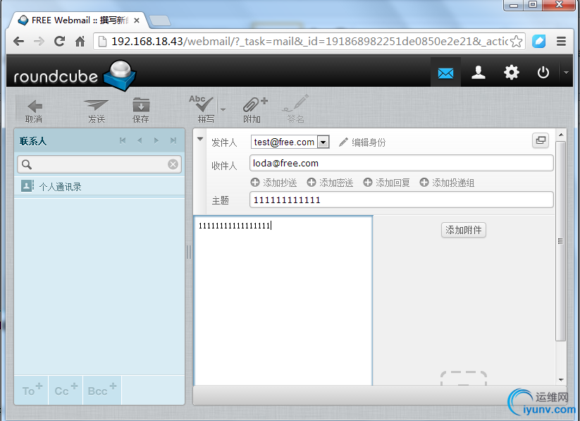

  从日志中我们可以看出进行了垃圾邮件过滤,嘿嘿,但效果不明显我们用Webmail测试一下,效果如下,
  这就是我们刚才测试的垃圾邮件,嘿嘿!下面我们再发一封测试一下,
  这是我们用test@free.com发给loda@free.com的邮件,我们用loda@free.com接收一下看看效果,
  可以看到,当loda接收到这封邮件时,被标记为垃圾邮件!至此所有演示全部完成,嘿嘿,下面我们查看一下所启动的所有服务!

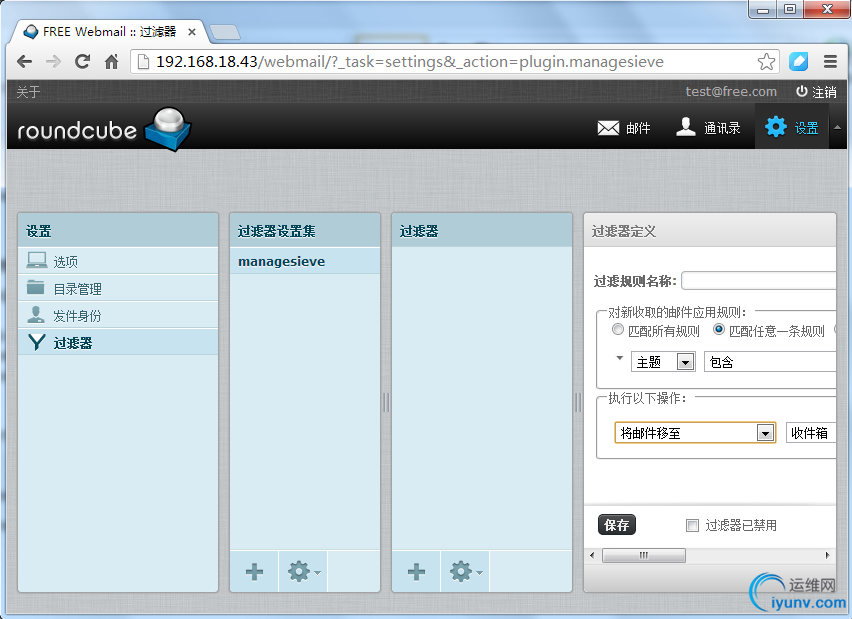

  十三、安装并配置managesieve插件
  说明,managesieve插件实现邮件过滤和Vacation功能
  1.在Doevecot2.0之后的版本,如果需要做邮件过滤的功能需要dovecot-pigeonhole扩展包的支持,
[iyunv@mail ~]# yum install -y dovecot-pigeonhole
  2.配置dovecot配置文件
[iyunv@mail ~]# vim /etc/dovecot/dovecot.conf
protocols = imap pop3 sieve
[iyunv@mail ~]# vim /etc/dovecot/conf.d/15-lda.conf
mail_plugins = quota sieve
  3.重新启动dovecot
[iyunv@mail ~]# service dovecot restart
Stopping Dovecot Imap:                                     [  OK  ]
Starting Dovecot Imap:                                     [  OK  ]
  4. 查看Dovecot监听4190端口
[iyunv@mail ~]# netstat -ntulp | grep 4190
tcp        0      0 0.0.0.0:4190                0.0.0.0:*                   LISTEN      17998/dovecot
[iyunv@mail ~]#
  5.managesieve配置文件修改,将模板复制成config.inc.php,做如下修改
[iyunv@mail ~]# cd /var/www/html/webmail/plugins/managesieve/
[iyunv@mail managesieve]# ls
Changelog  config.inc.php.dist  lib  localization  managesieve.js  managesieve.php  package.xml  skins  tests
[iyunv@mail managesieve]# cp config.inc.php.dist config.inc.php
[iyunv@mail managesieve]# vim config.inc.php
#修改端口为
$rcmail_config['managesieve_port'] = 4190;
  6.在主配置文件中使插件生效
[iyunv@mail ~]# vim  /var/www/html/webmail/config/main.inc.php
$rcmail_config['plugins'] = array('managesieve');
  7.效果测试
  好了测试成功!Roundcubemail 插件很多,有需要的朋友自行增加就行,^_^……
