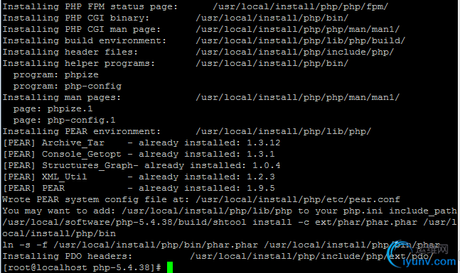

  4、安装PHP
  (1)tar zvxf php-5.2.10.tar.bz2
(2)cd php-5.2.10
  (3)
  ./configure -prefix=/usr/local/install/php --with-config-file-path=/etc --with-mysql=/usr/local/install/mysql --with-mysqli=/usr/local/install/mysql/bin/mysql_config --with-pdo-mysql=/usr/local/install/mysql --with-iconv-dir=/usr/local --with-freetype-dir --with-jpeg-dir --with-png-dir --with-zlib --with-libxml-dir=/usr --enable-xml --disable-rpath --enable-discard-path --enable-safe-mode --enable-bcmath --enable-shmop --enable-sysvsem --enable-inline-optimization --with-curl --with-curlwrappers --enable-mbregex --enable-fastcgi --enable-fpm --enable-force-cgi-redirect --enable-mbstring --with-mcrypt --with-gd --enable-gd-native-ttf --with-openssl --with-mhash --enable-pcntl --enable-sockets --with-ldap --with-ldap-sasl ---with-apxs2=/usr/local/install/apache/bin/apxs
  (4)make
  (5)make install
