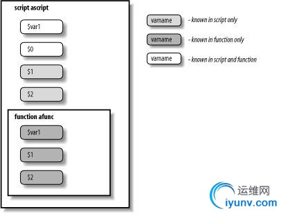

Figure 4-3 shows the scope of each variable in our new script. Note that afunc now has its own, local copy of var1, although the original var1 would still be used by any other functions that ascript invokes.
Figure 4-3. Functions can have local variables
