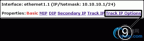

DSC00011.gif From the Sub-Interface, click Edit:
DSC00013.gif From Properties, click Track IP Options:

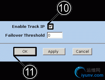

DSC00015.gif Select the Enable Track IP check box:
Click OK.
