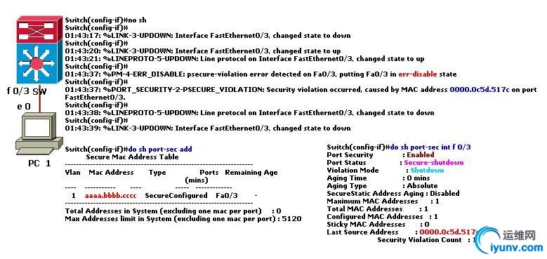

配置Port Security最大MAC数目,违背处理方式,恢复方法:
Cat4507(config)#int fastEthernet
       Cat4507 (config-if)#switchport mode access
Cat4507 (config-if)#switchport port-security
Cat4507 (config-if)#switchport port-security maximum 2
       Cat4507 (config-if)#switchport port-security mac-address aaaa.bbbb.cccc
Cat4507 (config-if)#switchport port-security violation shutdown
Cat4507 (config)#errdisable recovery cause psecure-violation
                                                                  /让err-disable接口自动恢复
Cat4507 (config)#errdisable recovery interval 30
通过配置sticky port-security学得的MAC:
interface FastEthernet3/29
switchport port-security maximum 5
switchport port-security mac-address sticky
switchport port-security mac-address sticky 000b.db1d.6ccd
switchport port-security mac-address sticky 000b.db1d.6cce
switchport port-security mac-address sticky 000d.6078.2d95
switchport port-security mac-address sticky 000e.848e.ea01
Sw1#show port-security
Sw1#show port-security address  可以看到授权的MAC地址
Sw1#show port-security interface f0/1
Sw1#show interfaces fastEthernet 0/1
FastEthernet0/1 is down, line protocol is down (err-disabled)
通常做接口安全,要先把接口shut down,这样它就不会自动学习
让err-disable接口自动恢复
show errdisable
