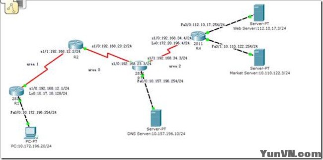

网络拓扑图:
OSPF多区域配置
R1:
Router>
Router>en
Router#conf t
Enter configuration commands, one per line. End with CNTL/Z.
Router(config)#no ip domain lookup
Router(config)#hostname Rz1
Rz1(config)#int s1/0
Rz1(config-if)#ip address 192.168.12.1 255.255.255.0
Rz1(config-if)#no shut
Rz1(config-if)#exit
Rz1(config)#int lo0
Rz1(config-if)#ip address 10.17.10.128 255.255.255.0
Rz1(config-if)#exit
Rz1(config)#int fa0/0
Rz1(config-if)#ip address 10.172.196.254 255.255.255.0
Rz1(config-if)#exit
Rz1(config)#router ospf 11 =================配置OSPF协议
Rz1(config-router)#router-id 1.1.1.1
Rz1(config-router)#network 192.168.12.0 0.0.0.255 area 1
Rz1(config-router)#network 10.17.10.0 0.0.0.255 area 1
Rz1(config-router)#network 10.172.196.0 0.0.0.255 area 1
Rz1(config-router)#end
%SYS-5-CONFIG_I: Configured from console by console
Rz1#write
Building configuration...
[OK]
Rz1#
R2:
Router>
Router>en
Router#conf t
Router(config)#hostname Rz2
Rz2(config)#int s1/1
Rz2(config-if)#ip address 192.168.12.2 255.255.255.0
Rz2(config-if)#clock rate 56000
Rz2(config-if)#no shut
%LINK-5-CHANGED: Interface Serial1/1, changed state to up
Rz2(config-if)#exit
%LINEPROTO-5-UPDOWN: Line protocol on Interface Serial1/1, changed state to up
Rz2(config-if)#exit
Rz2(config)#int s1/0
Rz2(config-if)#ip address 192.168.23.2 255.255.255.0
%LINK-5-CHANGED: Interface Serial1/0, changed state to down
Rz2(config-if)#exit
Rz2(config)#router ospf 22 =================配置OSPF协议
Rz2(config-router)#router-id 2.2.2.2
Rz2(config-router)#network 192.168.12.0 0.0.0.255 area 1
Rz2(config-router)#network 192.168.23.0 0.0.0.255 area 0
Rz2(config-router)#end
Rz2#write
[OK]
Rz2#
R3:
Router>
Router>en
Router#conf t
Router(config)#hostname Rz3
Rz3(config)#int s1/0
Rz3(config-if)#ip address 192.168.23.3 255.255.255.0
Rz3(config-if)#no shut
Rz3(config-if)#exit
Rz3(config)#int s1/1
Rz3(config-if)#ip address 192.168.34.3 255.255.255.0
Rz3(config-if)#clock rate 56000
Rz3(config-if)#exit
Rz3(config)#int fa0/0
Rz3(config-if)#ip address 10.157.196.254 255.255.255.0
Rz3(config-if)#exit
Rz3(config)#router ospf 33 =====================配置OSPF协议
Rz3(config-router)#router-id 3.3.3.3
Rz3(config-router)#network 10.157.196.0 0.0.0.255 area 0
Rz3(config-router)#network 192.168.23.0 0.0.0.255 area 0
Rz3(config-router)#network 192.168.34.0 0.0.0.255 area 1
Rz3(config-router)#end
Rz3#write
[OK]
Rz3#
R4:
Router>
Router>en
Router#conf t
Router(config)#hostname Rz4
Rz4(config)#int s1/0
Rz4(config-if)#ip address 192.168.34.4 255.255.255.0
Rz4(config-if)#no shut
%LINK-5-CHANGED: Interface Serial1/0, changed state to up
Rz4(config-if)#exit
Rz4(config)#int lo0
Rz4(config-if)#ip address 172.20.196.4 255.255.255.0
Rz4(config-if)#exit
Rz4(config)#int fa0/0
Rz4(config-if)#ip address 112.10.17.254 255.255.255.0
Rz4(config-if)#exit
Rz4(config)#int fa0/1
Rz4(config-if)#ip address 10.110.122.254 255.255.255.0
Rz4(config-if)#exit
Rz4(config)#router ospf 44 =========配置OSPF协议
Rz4(config-router)#router-id 4.4.4.4
Rz4(config-router)#network 192.168.34.0 0.0.0.255 area 2
Rz4(config-router)#network 172.20.196.0 0.0.0.255 area 2
Rz4(config-router)#network 10.110.122.0 0.0.0.255 area 2
Rz4(config-router)#network 112.10.17.0 0.0.0.255 area 2
Rz4(config-router)#end
Rz4#write
[OK]
Rz4#
配置完成。
