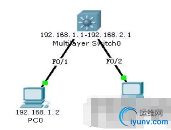

[经验分享] 三层交换机的路由功能固定IP地址的方法实现不同vlan之间联通
发表于 2016-2-22 10:07:31 | 显示全部楼层 |阅读模式
配置过程
Switch>
Switch>en
Switch#
Switch#conf t
Enter configuration commands, one per line.  End with CNTL/Z.
Switch(config)#ip routing
提示:一定要开启路由功能
Switch(config)#int fa0/1
Switch(config-if)#no switchport
Switch(config-if)#
%LINEPROTO-5-UPDOWN: Line protocol on Interface FastEthernet0/1, changed state to down
%LINEPROTO-5-UPDOWN: Line protocol on Interface FastEthernet0/1, changed state to up
Switch(config-if)#
Switch(config-if)#ip address 192.168.1.1 255.255.255.0
Switch(config-if)#no shut
Switch(config-if)#end
Switch#
%SYS-5-CONFIG_I: Configured from console by console
Switch#
Switch#int fa0/2
% Invalid input detected at '^' marker.
Switch#
Switch#conf t
Switch(config)#int fa0/2
Switch(config-if)#
%LINEPROTO-5-UPDOWN: Line protocol on Interface FastEthernet0/2, changed state to down
%LINEPROTO-5-UPDOWN: Line protocol on Interface FastEthernet0/2, changed state to up
Switch(config-if)#
Switch(config-if)#ip address 192.168.2.1 255.255.255.0
Switch#
Switch#

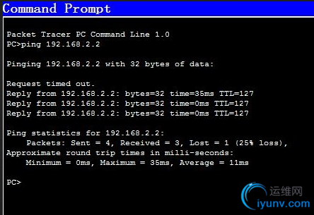

测试结果
