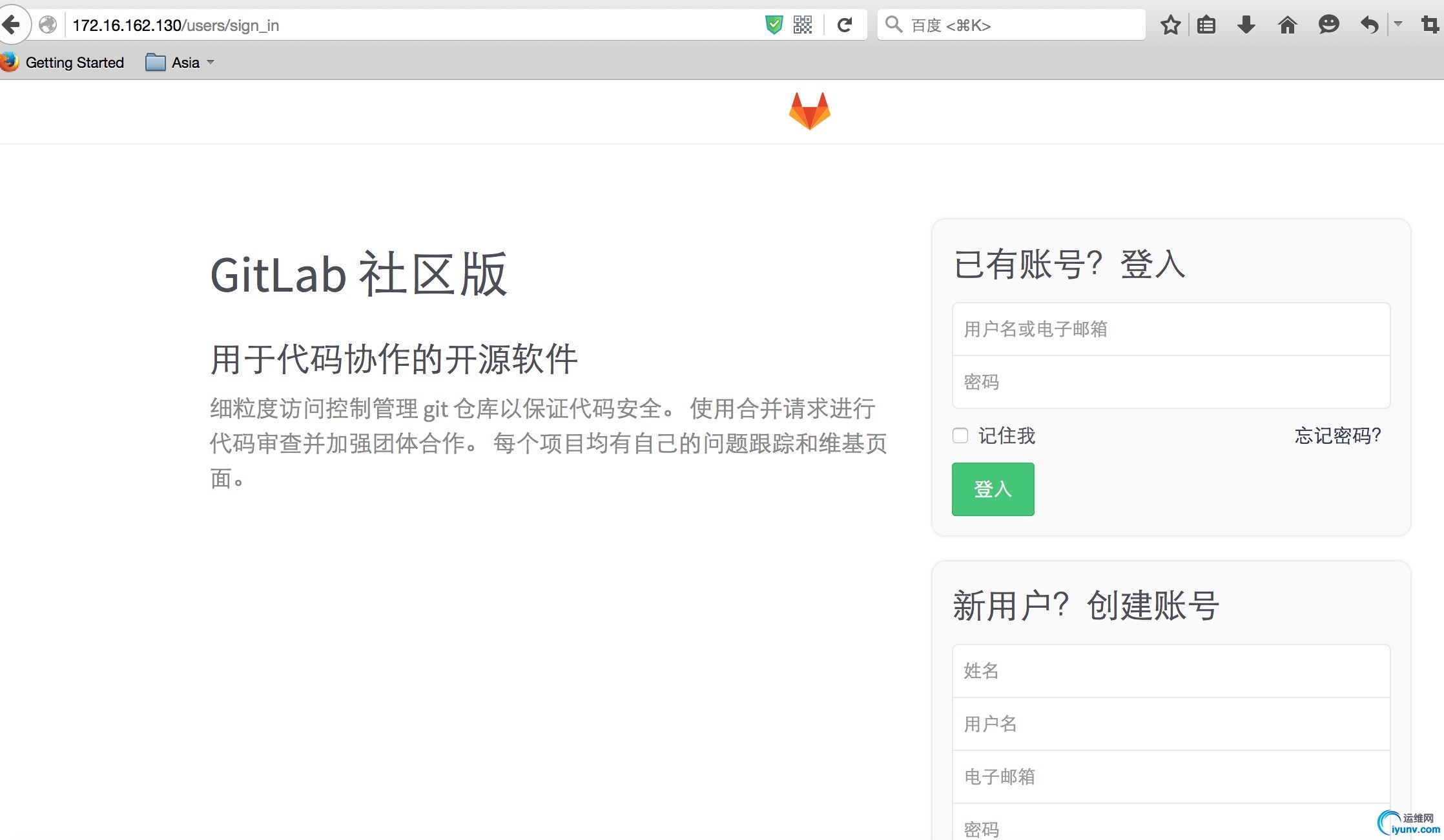

13、初始化数据库并激活高级功能  (lansgg123为 web管理员root的密码)
[git@node1 gitlab-git-http-server]$ cd ~/gitlab
[git@node1 gitlab]$ bundle exec rake gitlab:setup RAILS_ENV=production GITLAB_ROOT_PASSWORD=lansgg123

[git@node1 gitlab]$ bundle exec rake gitlab:env:info RAILS_ENV=production
System information
System:         RedHatEnterpriseServer 6.5
Current User:   git
Using RVM:      no
Ruby Version:   2.2.3p173
Gem Version:    2.4.5.1
Bundler Version:1.11.2

17、启动服务,测试:
9
10
11
12
13
[iyunv@node1 sbin]# ./nginx
[iyunv@node1 sbin]# pwd
/opt/soft/nginx/sbin
[iyunv@node1 sbin]#
[iyunv@node1 sbin]# /etc/init.d/gitlab start
Starting GitLab Unicorn
Starting GitLab Sidekiq
Starting gitlab-git-http-server
The GitLab Unicorn web server with pid 10956 is running.
The GitLab Sidekiq job dispatcher with pid 11004 is running.
The gitlab-git-http-server with pid 10987 is running.
GitLab and all its components are up and running.
[iyunv@node1 sbin]#
启动gitlab前,要修改gitlab的启动程序。 (下面两行)
app_user="git"
app_root="/opt/$app_user/gitlab"
访问地址:http://172.16.162.130/
