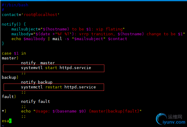

    notify_master "/etc/keepalived/notify.sh master"
    notify_backup "/etc/keepalived/notify.sh backup"
    notify_fault "/etc/keepalived/notify.sh fault"

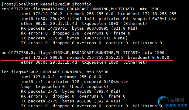

                ##systemctl start keepalived.servcie
    测试一下:
        主备节点:
            备主节点:
