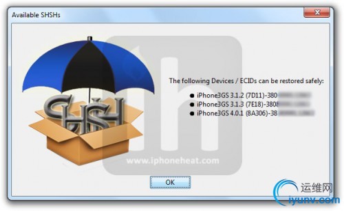

Step 3 – Start TSS Server
iPhone 3G and iPod Touch 2G (Non-MC) please skip to step 4. iPhone 3GS and iPod Touch 3G and iPod Touch 2G (MC) users:
  • Run the TinyUmbrella
  • Hit the Display SHSH button to confirm that downloaded SHSH blobs has been cached by TinyUmbrella for 3.1.3 or 3.1.2. (If you already have them in your PC, drag and drop the SHSH blobs in the TinyUmbrella window then hit the display SHSH blobs button to confirm). See the screenshot below.
  • Then hit the Start TSS Server button
