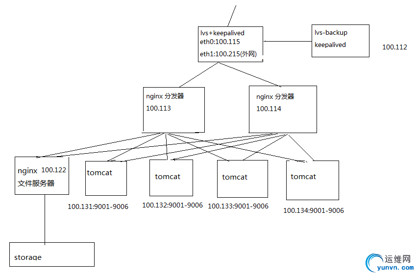

LVS
IP:
Eth0:192.168.100.115
Eth1:192.168.100.215
Vi /etc/init.d./lvs
#!/bin/sh
# lvs     Start lvs
# chkconfig: 2345 08 92
# description:  Starts, stops and saves lvs
SNS_VIP=192.168.100.215
SNS_RIP1=192.168.100.114
SNS_RIP2=192.168.100.113

LVS-realserver
Ip 192.168.100.113
Ip 192.168.100.114
Vi  /etc/init.d/rsup
#!/bin/bash
VIP=192.168.100.215
ifconfig lo:0 $VIP broadcast $VIP netmask255.255.255.255 up
#route add –host $VIP dev lo:0
echo "1">/proc/sys/net/ipv4/conf/lo/arp_ignore
echo "2">/proc/sys/net/ipv4/conf/lo/arp_announce
echo "1">/proc/sys/net/ipv4/conf/all/arp_ignore
echo "2">/proc/sys/net/ipv4/conf/all/arp_announce
#sysctl –p
Nginx
Ip 192.168.100.122(nfs)
Ip 192.168.100.113
Ip 192.168.100.114
