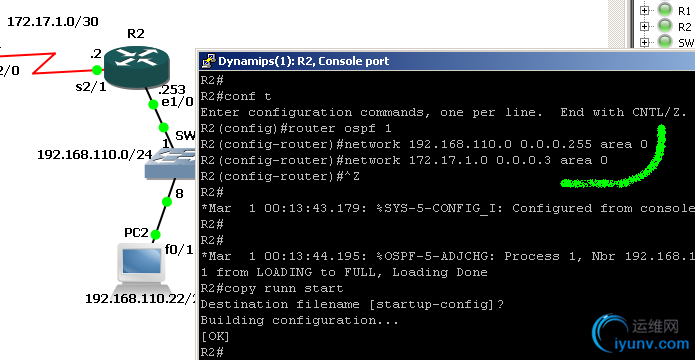

  R2:
R2#
R2#conf t
Enter configuration commands, one per line.  End with CNTL/Z.
R2(config)#router ospf 1
R2(config-router)#network 192.168.110.0 0.0.0.255 area 0
R2(config-router)#network 172.17.1.0 0.0.0.3 area 0
R2(config-router)#^Z
R2#
*Mar  1 00:13:43.179: %SYS-5-CONFIG_I: Configured from console by console
R2#
*Mar  1 00:13:44.195: %OSPF-5-ADJCHG: Process 1, Nbr 192.168.100.254 on Serial2/1 from LOADING to FULL, Loading Done
R2#copy runn start
Destination filename [startup-config]?
Building configuration...
[OK]
R2#

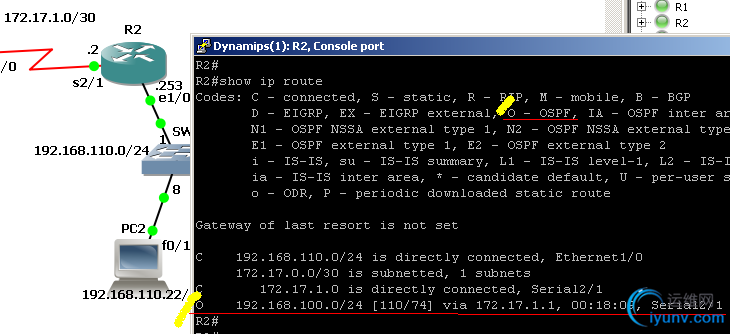

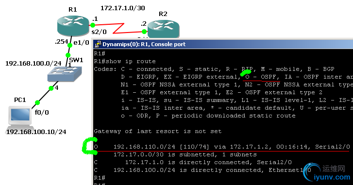

   (5) 启用路由协议后的路由信息
  R1:
  R2:
