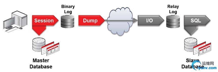

4 mysql复制线程
master会为每一个slave启动1个dump线程
master:dump
slave:IO_thread,SQL_thread
可单独启动
mysql> start slave IO_thread
mysql> start slave SQL_thread

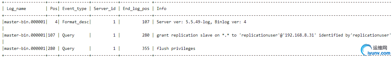

3 查看master二进制日志文件状态,在slave上需要使用
mysql> show master status;
| File              | Position | Binlog_Do_DB | Binlog_Ignore_DB |
| master-bin.000001 |      355 |              |                  |
mysql> show binlog events in "master-bin.000001";
