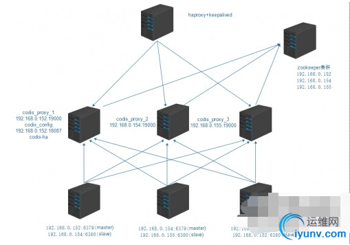

架构:

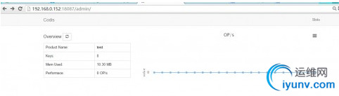

启动dashboard(可以写成脚本的形式)
/usr/local/codis/bin/codis-config /usr/local/codis/conf/config.inidashboard &
初始化solt(可以写成脚本的形式)
/usr/local/codis/bin/codis-config -c/usr/local/codis/conf/config.ini slot init –f
通过http://192.168.0.152:18087来打开网页

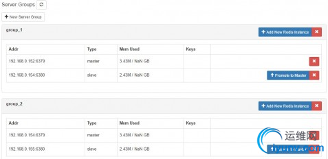

添加servergroups,每一个server groups作为一个codis服务器组,且每一个组只有一个master多个slave;
[iyunv@localhost scripts]# /usr/local/codis/bin/codis-config -c /usr/local/codis/conf/config.ini server add 1 192.168.0.152:6379 master
[iyunv@localhost scripts]# /usr/local/codis/bin/codis-config -c /usr/local/codis/conf/config.ini server add 1 192.168.0.154:6380 slave
[iyunv@localhost scripts]# /usr/local/codis/bin/codis-config -c /usr/local/codis/conf/config.ini server add 2 192.168.0.154:6379 master
[iyunv@localhost scripts]# /usr/local/codis/bin/codis-config -c /usr/local/codis/conf/config.ini server add 2 192.168.0.155:6380 slave
[iyunv@localhost scripts]# /usr/local/codis/bin/codis-config -c /usr/local/codis/conf/config.ini server add 3 192.168.0.155:6379 master
[iyunv@localhost scripts]# /usr/local/codis/bin/codis-config -c /usr/local/codis/conf/config.ini server add 3 192.168.0.152:6380 slave

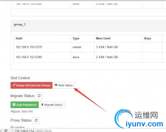

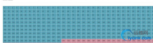

设置 servergroup 服务的 slot 范围 Codis 采用 Pre-sharding 的技术来实现数据的分片, 默认分成 1024 个 slots (0-1023), 对于每个key来说, 通过以下公式确定所属的 Slot Id : SlotId = crc32(key) % 1024 每一个 slot 都会有一个且必须有一个特定的 server group id 来表示这个 slot 的数据由哪个 server group 来提供.
[iyunv@localhost scripts]# /usr/local/codis/bin/codis-config -c /usr/local/codis/conf/config.ini slot range-set 0 300 1 online
[iyunv@localhost scripts]# /usr/local/codis/bin/codis-config -c /usr/local/codis/conf/config.ini slot range-set 301 700 2 online
[iyunv@localhost scripts]# /usr/local/codis/bin/codis-config -c /usr/local/codis/conf/config.ini slot range-set 701 1023 3 online

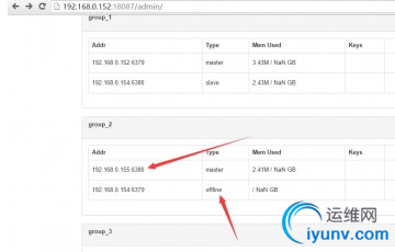

配置codis-ha,实现codis-server的主从切换,主库挂了会提升一个从库为主库,从库挂了会将这个从库直接下线;注:任意一台配置即可;
9
10
[iyunv@localhost ~]# go get github.com/ngaut/codis-ha
[iyunv@localhost ~]# cd /usr/local/codis/src/github.com/ngaut/
[iyunv@localhost ngaut]# cp -r codis-ha /usr/local/
[iyunv@localhost ngaut]# cd /usr/local/codis
[iyunv@localhost codis]# cd ..
[iyunv@localhost local]# cd /usr/local/codis-ha/
[iyunv@localhost codis-ha]# go build
创建codis-ha启动脚本
[iyunv@localhost codis-ha]# vim /usr/local/codis-ha/start_codis_ha.sh
./codis-ha--codis-config=192.168.0.152:18087 -log-level="info" --productName=vmware-Codis&> ./logs/codis-ha.log &
9
10
11
12
13
14
15
16
创建日志目录
[iyunv@localhost codis-ha]# mkdir /usr/local/codis-ha/logs
启动codis-ha
[iyunv@localhost codis-ha]# sh start_codis_ha.sh
[iyunv@localhost codis-ha]# ps aux | grep codis-ha
root      51524  0.2 1.1 128584 11596 pts/1    Sl   00:15  0:00 ./codis-ha --codis-config=192.168.0.152:18087 -log-level=info--productName=vmware-Codis
root      51534  0.0 0.0 103252   836 pts/1    S+  00:20   0:00 grep codis-ha
现在把154机上codis主下线
[iyunv@localhost codis]# ps aux | grep codis
root      49177  0.1 1.1 141484 11684 ?        Ssl  20:47  0:20 /usr/local/codis/bin/codis-server *:6379
root      49181  0.1 0.9 137388  9624 ?        Ssl 20:47   0:18 /usr/local/codis/bin/codis-server*:6380
root      49295  0.0 0.0 103252   836 pts/0    S+  23:43   0:00 grep codis
[iyunv@localhost codis]# kill 49177
root      49181  0.1 0.9 137388  9624 ?        Ssl  20:47  0:18 /usr/local/codis/bin/codis-server *:6380
root      49297  0.0 0.0 103252   832 pts/0    S+  23:43   0:00 grep codis
