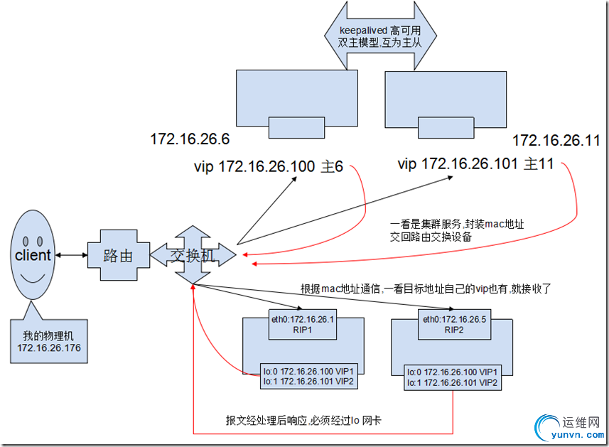

在这里,我们选用 dr模型来实现,拓普图如下

介绍完keepalived,我们开始小试牛刀, 在172.16.26.6,和172.16.26.11节点上配置keepalived 高可用

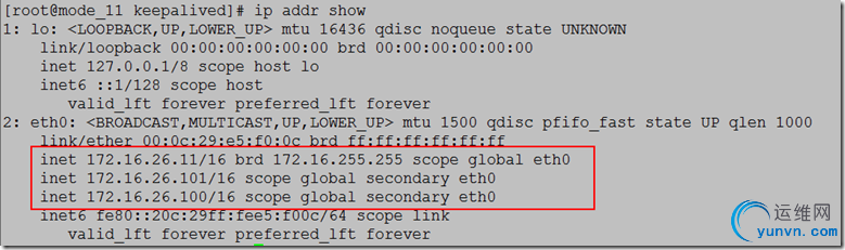

此时,我们先启动 172.16.26.11节点的keepalived的服务
[iyunv@mode_11 keepalived]# tail /var/log/messages             =>查看日志文件
Sep 21 21:11:06 mode_11 Keepalived_vrrp[7736]: VRRP_Instance(VI_2) Entering MASTER STATE
Sep 21 21:11:06 mode_11 Keepalived_vrrp[7736]: VRRP_Instance(VI_2) setting protocol VIPs.
Sep 21 21:11:06 mode_11 Keepalived_vrrp[7736]: VRRP_Instance(VI_2) Sending gratuitous ARPs on eth0 for 172.16.26.101
Sep 21 21:11:06 mode_11 Keepalived_healthcheckers[7735]: Netlink reflector reports IP 172.16.26.101 added
Sep 21 21:11:07 mode_11 Keepalived_vrrp[7736]: VRRP_Instance(VI_1) Transition to MASTER STATE
Sep 21 21:11:08 mode_11 Keepalived_vrrp[7736]: VRRP_Instance(VI_1) Entering MASTER STATE
Sep 21 21:11:08 mode_11 Keepalived_vrrp[7736]: VRRP_Instance(VI_1) setting protocol VIPs.
Sep 21 21:11:08 mode_11 Keepalived_healthcheckers[7735]: Netlink reflector reports IP 172.16.26.100 added
Sep 21 21:11:08 mode_11 Keepalived_vrrp[7736]: VRRP_Instance(VI_1) Sending gratuitous ARPs on eth0 for 172.16.26.100
Sep 21 21:11:11 mode_11 Keepalived_vrrp[7736]: VRRP_Instance(VI_2) Sending gratuitous ARPs on eth0 for 172.16.26.101
=>因为只有它自己一个keepalived节点启动, 把172.16.26.100,172.16.26.100都配置到自己的网卡上了

现在启动 172.16.26.6节点上的 keepalived服务
[iyunv@php5_6 keepalived]# service keepalived start
此时,因为上面配置的该节点拥有172.16.26.100 ip的权重高,所以它就把这个ip配置到自己的网卡上了
172.16.26.1和172.16.26.5上都进行如下操作
# ifconfig lo:0 172.16.26.100 netmask 255.255.255.255 broadcast 172.16.26.100 up     =>给lo 起两别名, 添加两个虚拟地址
# ifconfig lo:1 172.16.26.101 netmask 255.255.255.255 broadcast 172.16.26.101 up
# route add -host 172.16.26.100 dev lo    而且必须是访问 lo口上拥有的ip才能允许报文进来
# route add -host 172.16.26.101 dev lo
# echo 2 > /proc/sys/net/ipv4/conf/all/arp_announce     只通告本接口拥有的ip地址
# echo 2 > /proc/sys/net/ipv4/conf/eth0/arp_announce
# echo 1 > /proc/sys/net/ipv4/conf/eth0/arp_ignore =>只响应目标IP地址是来访网络接口本地地址的ARP查询请求
# echo 1 > /proc/sys/net/ipv4/conf/all/arp_ignore

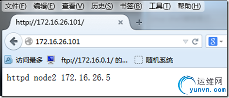

访问两个 virtual ip 都能解析到后端主机上,实验OK
# service keepalived stop =>我们停掉一个节点,测试一下两个vip的访问都是否正常
OK,实验完成,实现了高可用.
