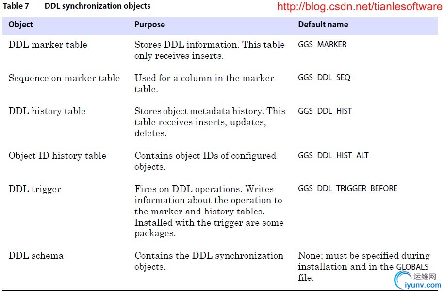

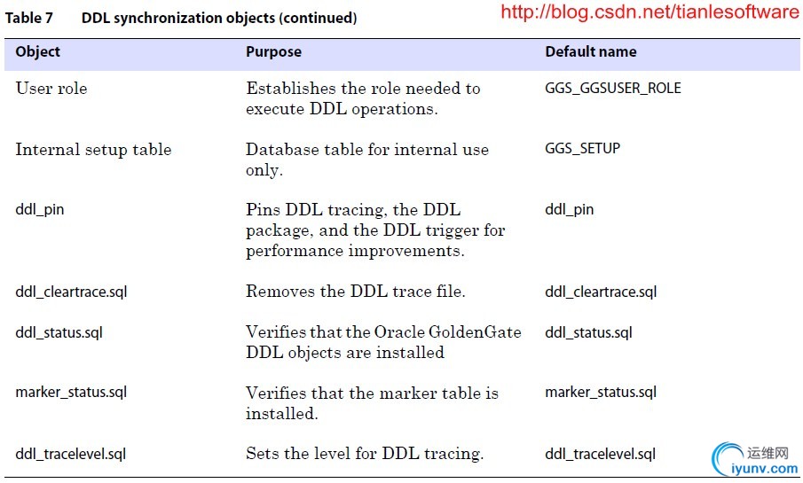

2.1 Overview of the DDL objects
  To install theOracle GoldenGate DDL environment, you will be installing the database objectsshown in Table 7.
  --启用DDL 需要安装以下的对象。

  6. (Optional) To change the names of otherobjects listed in Table 7, the changes must be made now, before proceeding withthe rest of the installation. Otherwise, you will need to stop OracleGoldenGate DDL processing and reinstall the DDL objects. It is recommended thatyou accept the default names of the database objects. To change any name inTable 7 (except the schema), do one or both of the following:
  --在table 7里列了DDL 需要的对象名称,如果需要修改这些对象的默认名称,按以下方式来操作:
  (1) Record all name changes in the params.sqlscript. Edit this script and change the appropriate parameters. Do not run thisscript.
  (2) List the names shown in Table 8 inthe GLOBALS file. The correct parameters to use are listed in the Parameter columnof the table.
